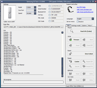

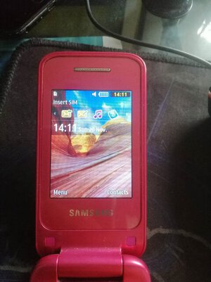

Good pm, mga ka Antgsm, Samsung gt-c3520 hang logo, done vis flashing Z3x.
Steps:
1. check muna yong usb pin kung malinis at detected kung ok, proceed step 2.
2. download this firmware: http://www.mediafire.com/file/2t2zh8a6eqdkadc/C3520XAKJ7.rar
3. open z3x 2g tool tapos hanapin yong brand ng unit,next..
4. tick to open firmware,then press 1 and 3 keypad sabay, tapos insert usb cord, wait until firmware done.
5. singilin n si tumer..hehe
Godbless us.
