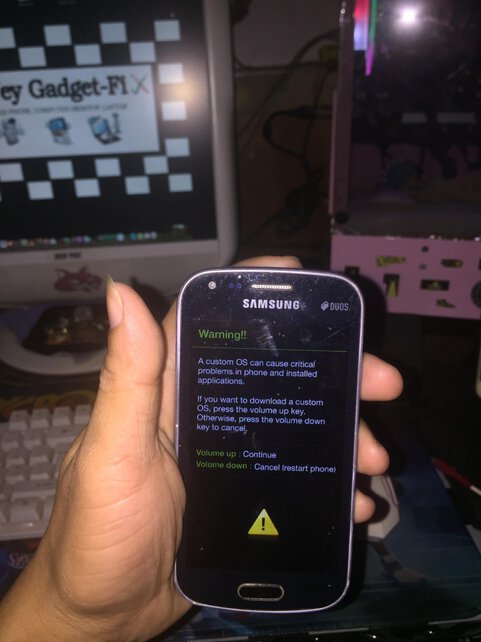

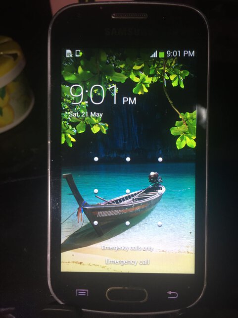

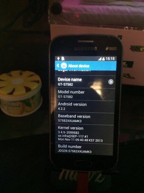

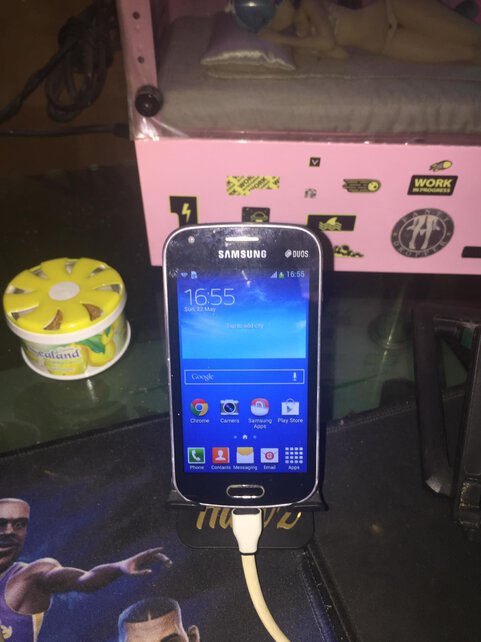

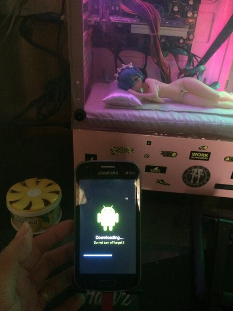

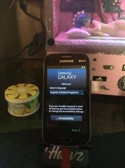

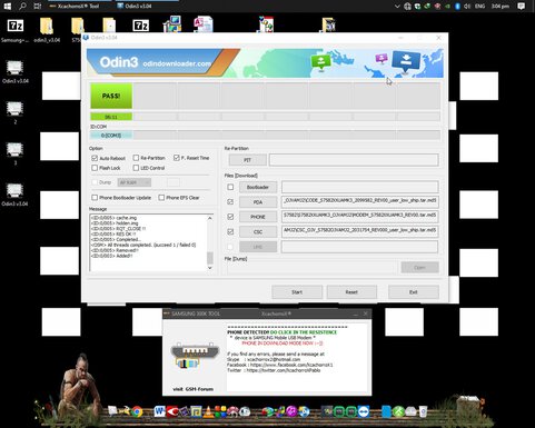

Share ko lang po ang bago kung gawa Samsung GT-S7582
Unit Status: ==> Pattern pass nakalimutan, Unit Super Hang ON talaga, Volume Down (V-) not so good in Function kaya ayaw mapadetect in DOWNLOAD MODE ang unit;
Unit Solved: ==> Using ODIN v3.04 + Samsung 300K Tool + TESTED FirmWare
Ginamitan ko pala ng SAMSUNG 300K TOOL para mapadetect and mapagana ang unit in DOWNLOAD MODE, kasi not so good in function ang Volume Down...

Mawalangalang Po Sir Sa Susunod Wag Mo Sana Habaan Ang Title Thank You For Share Your Post Thread
bakit niyo po hindi sinali ang bootloder sir?
Thank you po sa tanong mo dol..hindi po dapat sinali bootloader dol para hindi dilikado ang unit., for short iiwas tayo sa ala-nganin at lalo na sa abuno kay tumer ;);),
pero if status sa unit na hawak mo is you need to install custom firmware and full access doon sa administrative setting nya..yan unlock mo bootloader pero disadvantages kasi is by doing with this medyo malapit kana sa hard brick also it can cause hardware damage.
