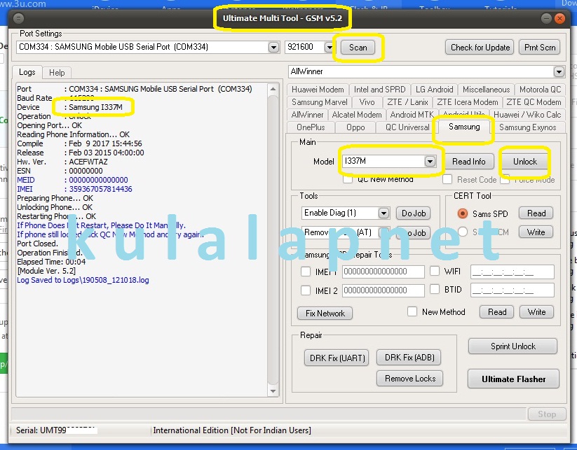

/open UMT GSM software
/goto Samsung tab
/click Scan
/select Samsung Mobile USB Serial Port
/select model i337m
/click Unlock
