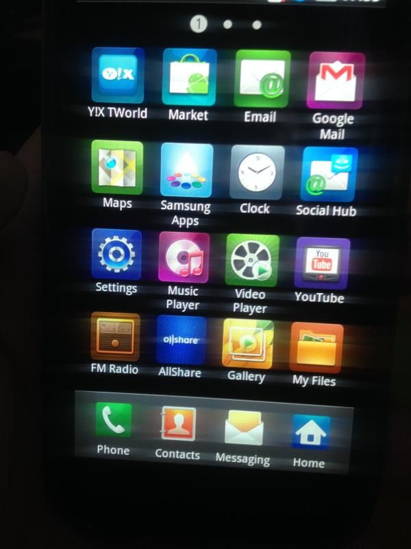

Ginamitan ko ng hard reset "VOLUME UP + HOME + POWER button" hindi matanggal ang TMPA.
Buti na lang may nakitang ibang procedure sa kaka search.
Ito ginawa ko.
Procedure :
1) Lagyan ng working SIM card
2) Tawagan mo ang number ng linagay mo gamit ang ibang cellphone.
2) Press ang touch button sa left side ng home button.
3) May makitang menu namay 3 options,"Contacts", "Notes" and "SIM servicesâ€￾.
4) Piliin ang "SIM services" and lower the drop-down menu at the top.
5) Press the home button (the square in the middle), Puntahan ang main menu, Settings, Privacy and data factory reset.
6) Done
