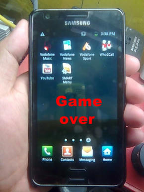

share ko lang gawa ko
model
Samsung i9100t Galaxy S II unlocked done by Z3X

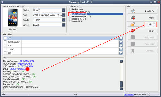

1-run samsung tool 3g
2-power on phone
3-go to MENU
4-SETTING
5-APPLICATIONS
6-DEVELOPEMET
7-put check USB DEBUGGING
8-connect phone using USB cable(ca-101)
9-then wait till driver is installed
10-select model on samsung tool software
11-put UNLOCK(root)
12-select right comport
13-then click UNLOCK
14-then wait ROOTING the phone(internet connections needed)
screenshot
DONE
