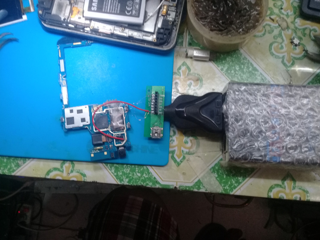

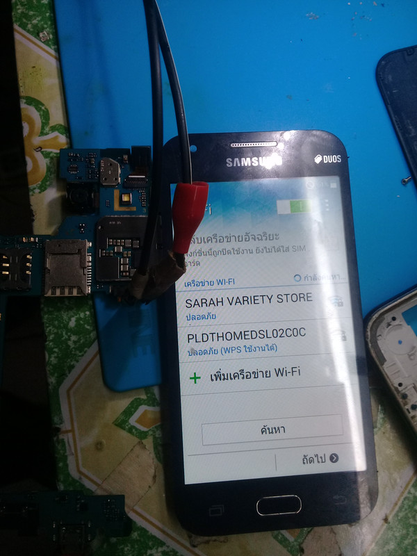

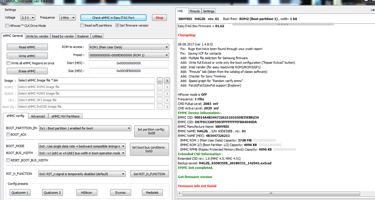

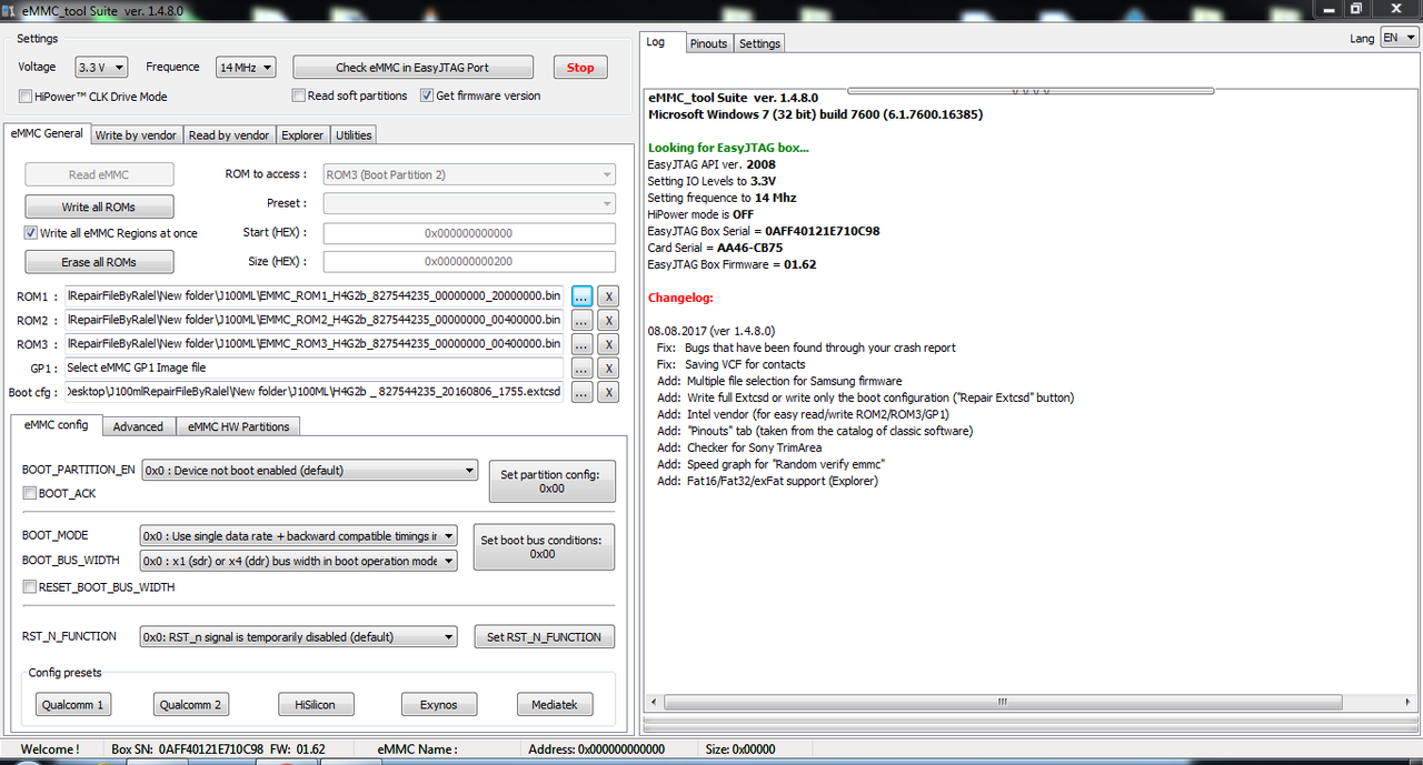

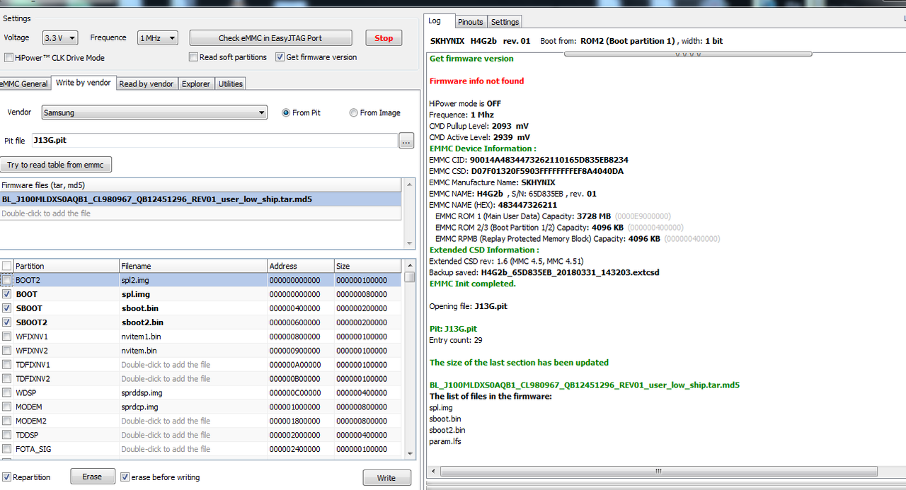

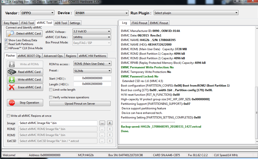

samsung j100ml dead revive by EASY JTAG

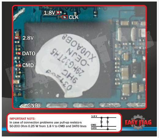

CHECK PINOUTS
AFTER MAKITA
AFTER PINOUTS
DOWLOAD FILE SA SUPPORT NI JTAG
CHECK KUNG CONNECTED LAHAT NG PINOUTS

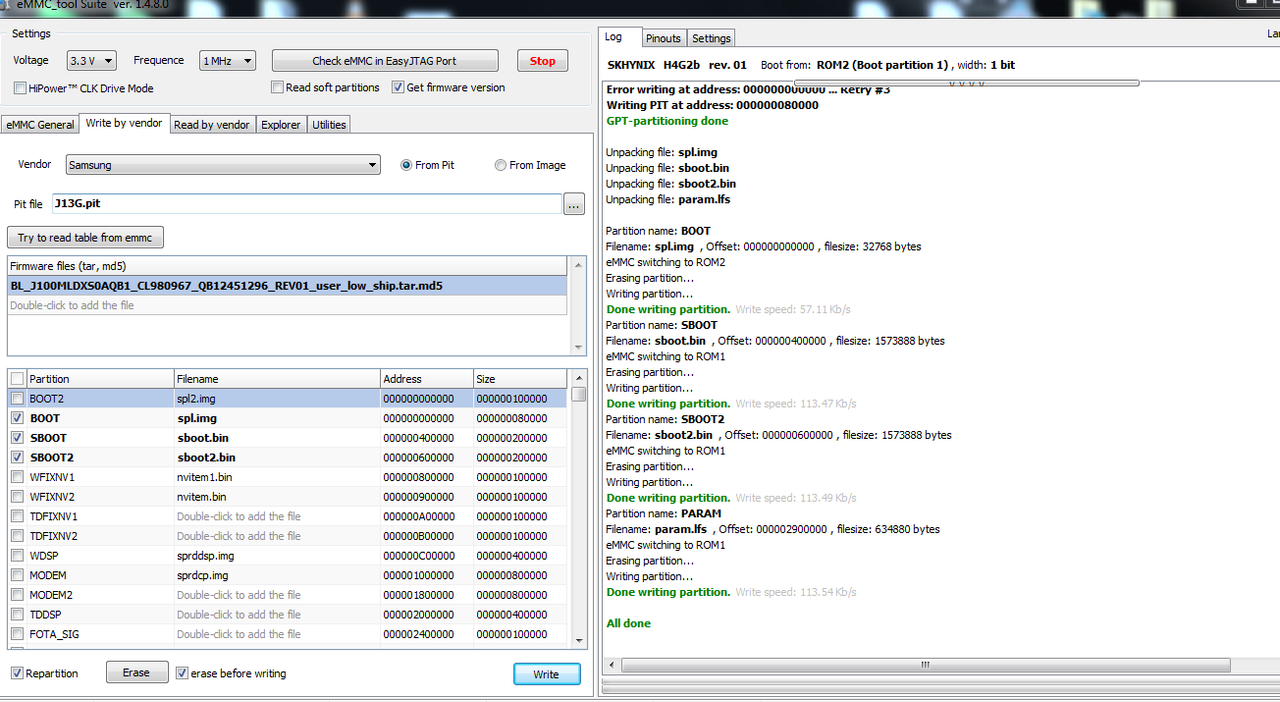

RUN EASYJTAG PLUS
CHECK EMMC IN EASY JTAG PORT
NEXT WRITE VENDOR
LOAD PIT FILE / BOOTLOADER THEN WRITE
DONE WRITE NA
TRY POWER ON ANG UNIT PERO STILL DEAD
KAYA WRITE FULL DUMP FILE

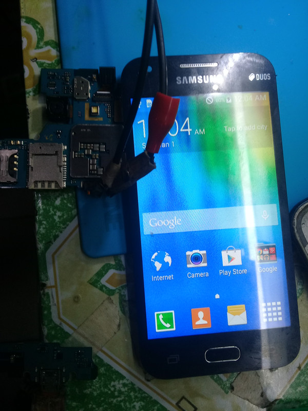

AFTER WRITE FULL DUMP

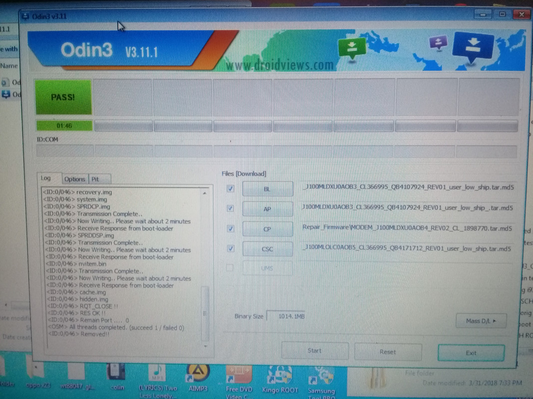

BOOT TO DOWNLOAD MODE AND FLASH ODIN
DONE SA FLASH SA ODIN
ALL DONE BUHAY NA ANG J100ML NI TUMER:)):)):))
SANA MAKATULONG KAHIT PAPANO
