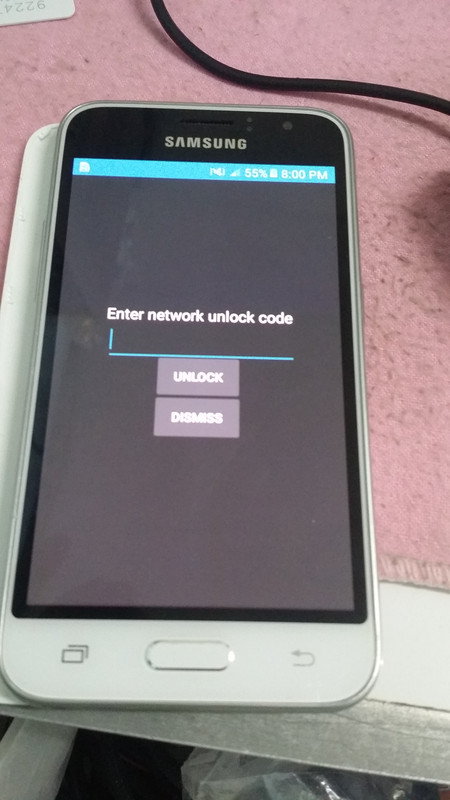

Insert non-accepted sim para malaman kung nanghihingi pa ng code

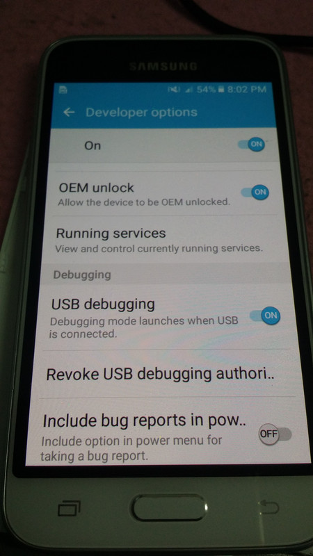

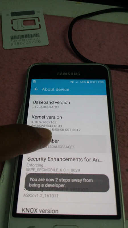

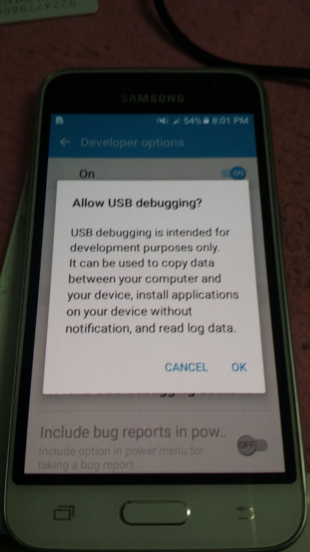

Switch on usb debbuging

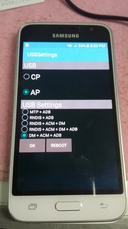

Press *#0808# and select DM+ACM+ADB then reboot

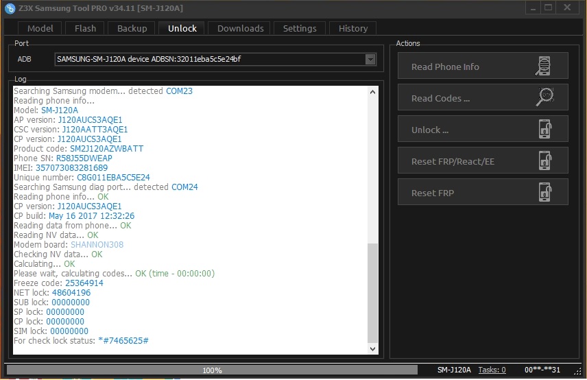

Open Z3X and select ADB
Press read codes and select Read Codes Diag
Restart cp and enter codes...​
