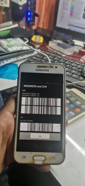

Model:j200gu/ds
Problem:no service/null imei..all apps ayw mag open
Action taken flash via odin..
Done...d q n napicture yung null p imei..
Note..naisipan q lng iflash dhil khit ireset unit my pop up p dn stopped pg nag oopen aq apps.....after flash pati imei ok n...sna mkatulong s mga newbie like me...
