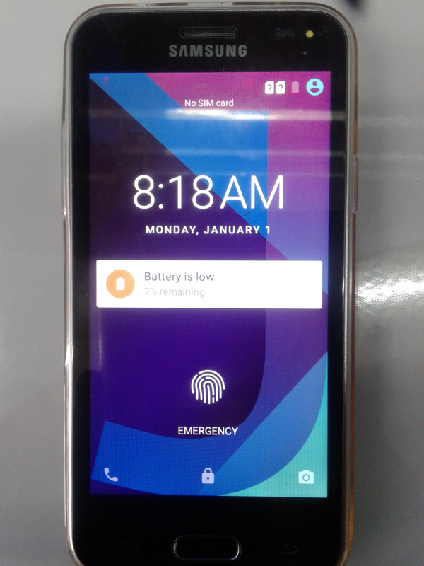

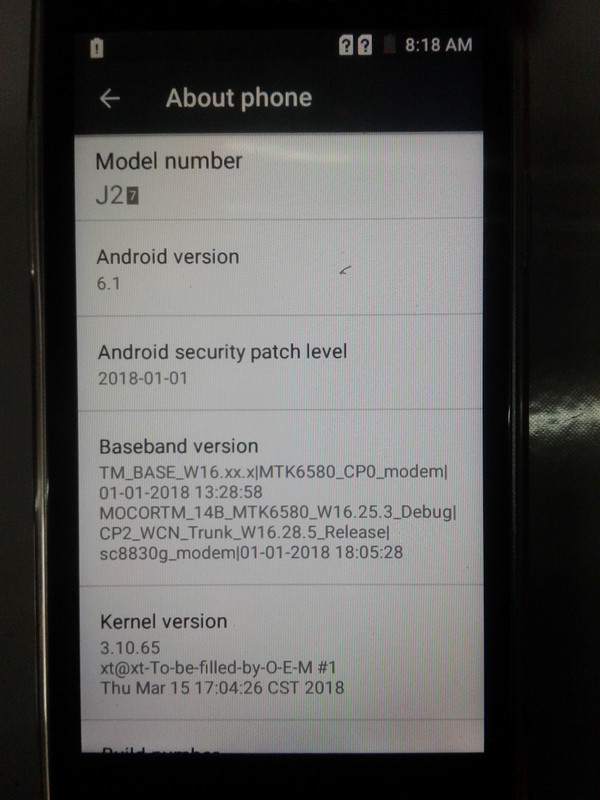

share lang mga boss
Samsung J27 Clone Spd Chipset
Dito ko po nakuha yung firmware
http://www.antgsm.com/showthread.php?p=1154887
credits po kay boss MIO I 125
ito po yung logs sa flashing gamit ang CM2SPD
unit done na po

unit done na po
