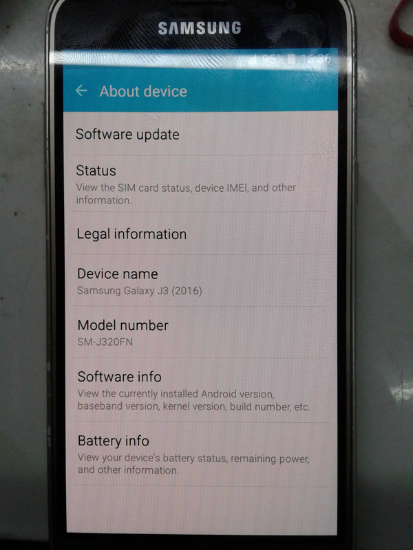

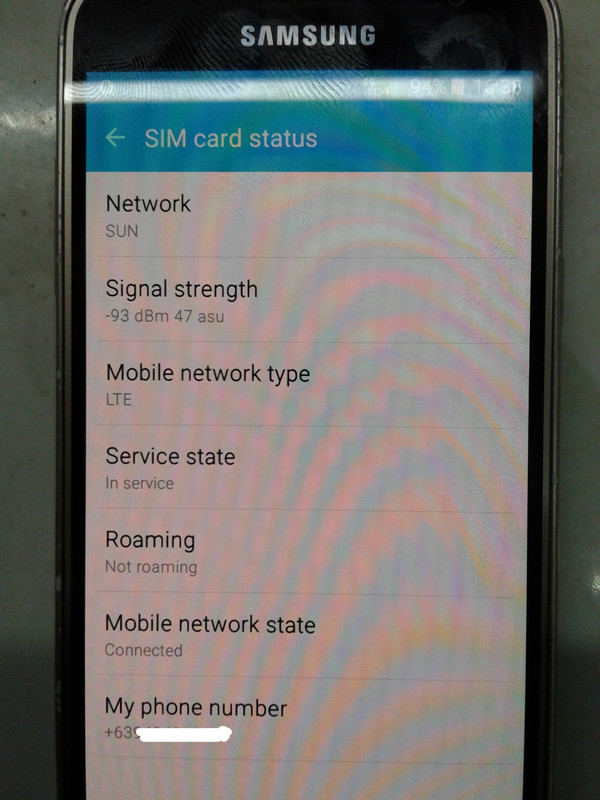

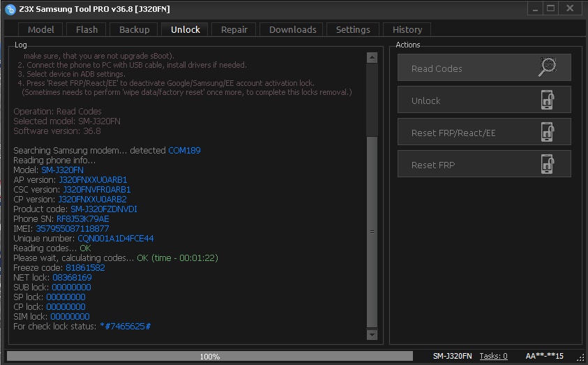

andreivi Expired Account Joined Jul 30, 2014 Messages 1,986 Reaction score 271 Points 381 Location Sison, Pangasinan/ Rosario, La Union Aug 16, 2019 #1 for reference lang Samsung J320FN Unlock done sa Z3x Pro turn unit on connect to usb open Z3xpro select correct model click unlock tab click readcodes maglagay ng unaccepted sim sa unit tapos i restart enter po yung codes sa unlock (NET Lock) done
