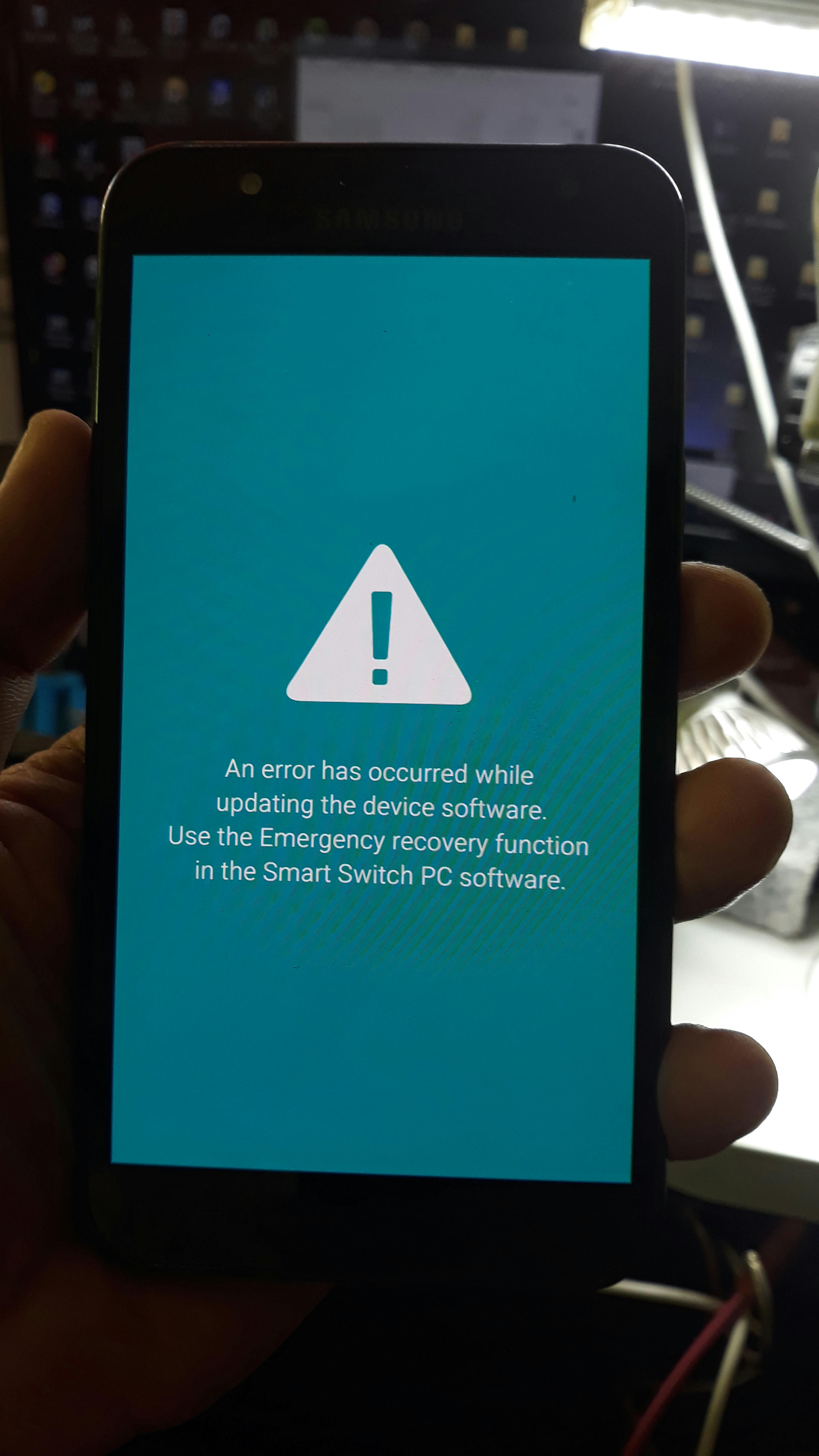

Phone History: Google account Problem at ginawa sa maling procedure kaya nagkaganito ang unit

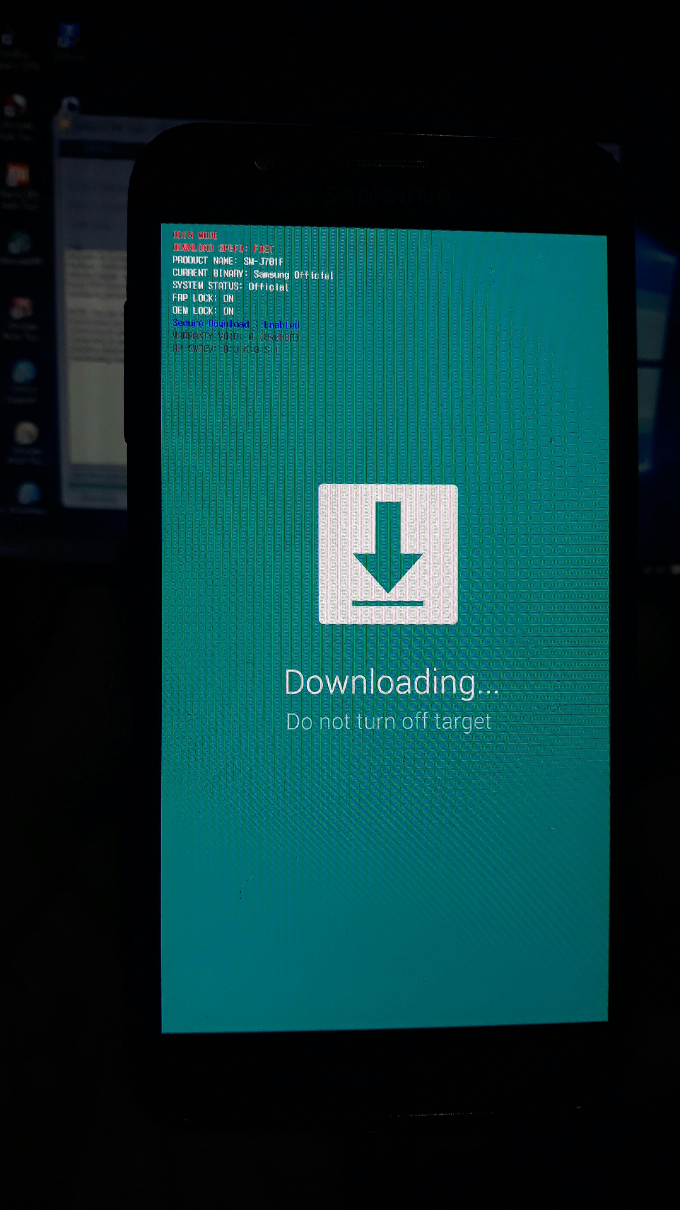

First DL this 2 firmware AP Only and Combination Files

Action Taken/ScreenShots

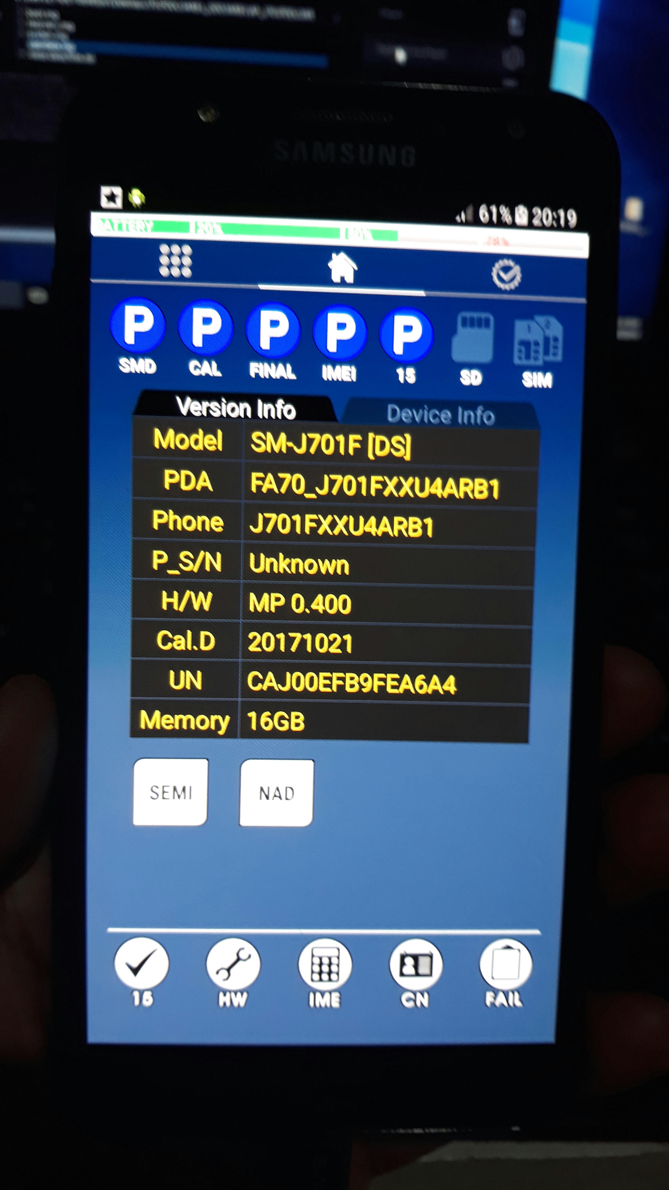

Flash using this combination and after flash use j710f model to remove FRP Done
j701f

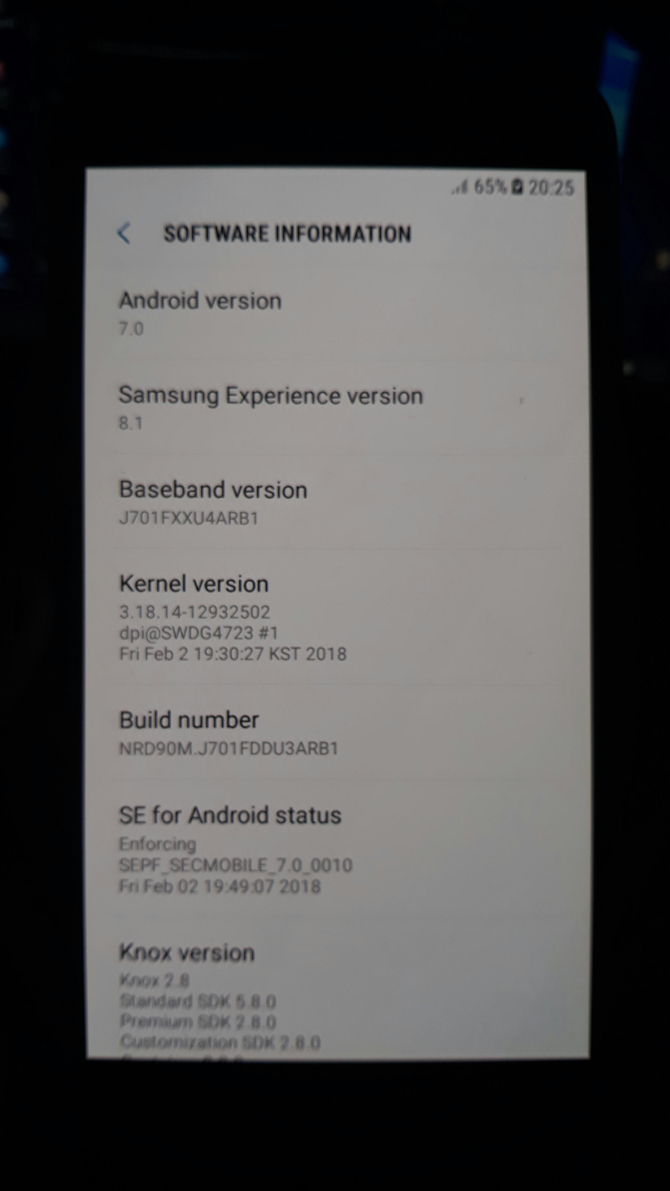

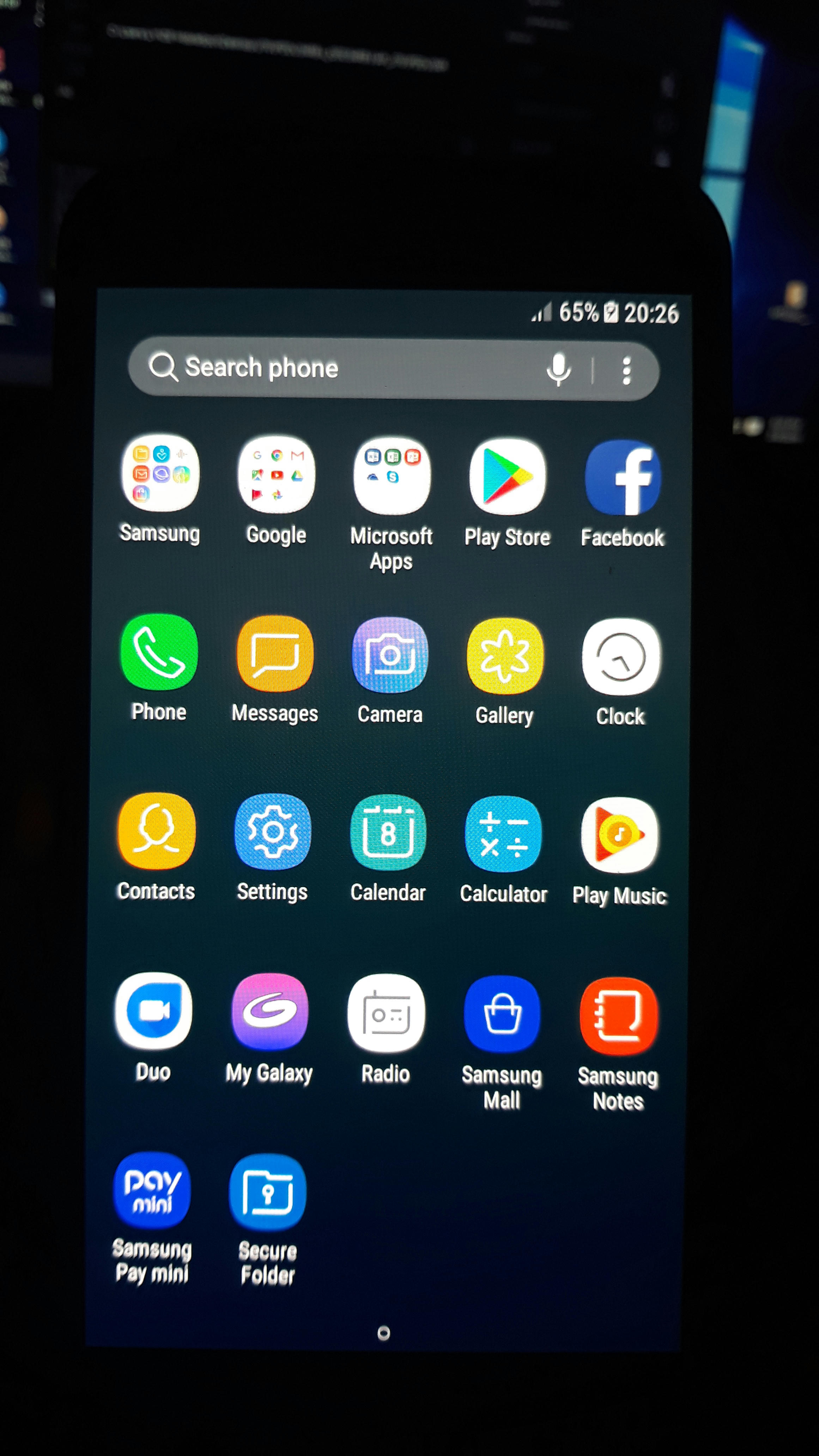

After remove FRP Flash again in this model J701f and load AP files and uncheck userdata para mawala na si FRP
frp
j701f_flash
Done..
