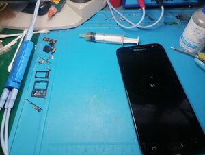

MODEL/UNIT
Samsung J7 Pro Sm-J730g/Ds
STATUS
Check Ko Lang Kung Gagana Ang Factory Code Para Ma Test Ang Touchscreen
Sa Pang 5 Kung Attempt Ayaw Gumana,Dahil Siguro May Pass...Hanggang Bigla
Nalang Nag Off..Swerte Iniwan Ng May Ari Na Buhay Ang Unit Tapos Pag Balik
Nya Dead Na...Kaya Medyo Kinabahan Kung Bakit Nga Naman Nadead Sa Pag Enter
Lang Ng Factory Code..So Kung Ano Ang Reason Yun Ang Di Ko Alam.Basta Ang Alam
Kolang Kailangan Maibalik Sa Dati...Para Di Magduda Ang Tomer...
PROCEDURE
1st Attempt Babad Muna Sa Charger Baka Low Bat Lang..
2nd Attempt Hold Vol Down + Power Hangang Sa Mag Reboot,Pero No Luck..
3rd Attempt Hold Vol Down + Power + Home Baka Sakali Tumuloy Sa Recovery,But No Luck Parin..
4th Attempt Last option Baklas Mode Na..:eek:
FINISH PRODUCT
Buti Sa Isang Move Natsambahan Agad..
Nag Shorted Pala Si Cap...

yong dalawang caps ba ni remove mo sir?
