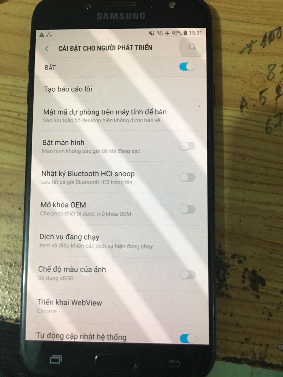

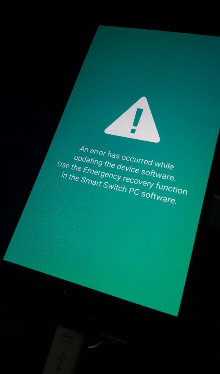

share ko lang sir baka makatulong nahirapan dn ako pero sa pag t tyaga nagawa ko dn sa tulong dn ng tahanan dito.bigay kopo procedure na ginawa ko sana gumana dn sa phone nio.J7 pro j730g model sa likod.
first step download mo muna miracle crack eto link.https://www.gsm1x.xyz/2018/04/miracle-box-v258-crack.html https://2.bp.blogspot.com/-mtcz_oJf...aoBy2XwA1HQCLcBGAs/s640/2018-04-02_140514.png

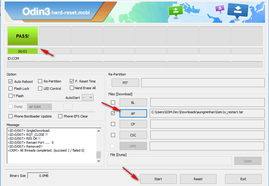

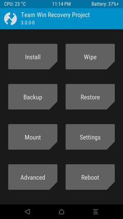

or kung may z3x ka click mo ung Reset reactivation EE/unlock after that.mag gaganto sayo. https://1.bp.blogspot.com/-mmryLjh2...b7i89NgCLcBGAs/s1600/9f21742fb654560a0f45.jpg dont worry wag ka magpanik may solution yan.eto gawin mo download mo to.https://123link.pro/qanDTSg9 https://3.bp.blogspot.com/-Vcvorm15...OOr5-9qoSwCLcBGAs/s1600/2018-09-24_172058.png tapos yan oks na gamit ka otg and mouse para ma turn off mo ung oem lalabas na yan for sure.bastat alam mo ung frp email mo kung hindi naman tech ka alam mo pano i bypass yan,https://1.bp.blogspot.com/-LP1ZGXCG...mMbKNNQCLcBGAs/s1600/50b3a69838e3d8bd81f2.jpg after nyan naka turn off na ung frp chaka oem nyan pwd na i flash sa odin using this file https://123link.pro/jwhZq https://2.bp.blogspot.com/-4j7gQpZ6...KyQEvU_kt-giK1Z5fVL_fXkJQCLcBGAs/s1600/ss.png https://1.bp.blogspot.com/-xxrckeu4...4wj48bVu3_0ZaR163nLNyr04fwCLcBGAs/s1600/s.png ung odin ganto tricks para lumabas yan turo saken ni Mam irene, uncheck mo ung auto reboot sa odin.pagkatapos mag pass pindutin volume down power button tapos pag nag reboot pindot agad power and volume up.labas na yan twrp tapos flash na using this file.https://123link.pro/xBOe tapos reboot na ok na.sana po nakatulong kahit papaano do your own risk po.dikopo masasabi sa lahat ng unit gagana yan.gusto ko lang makatulong Hit thanks po kung nakatulong mga ka ant thankyou God Bless u ALL.:):D

natapos ko nman ng completo boss y kaya after reboot restarting lang unit
ayon ok na..dumeretso na after wipe data..thanks

i wipe data mo muna mga sir bago nio i reboot.problem solved yan
