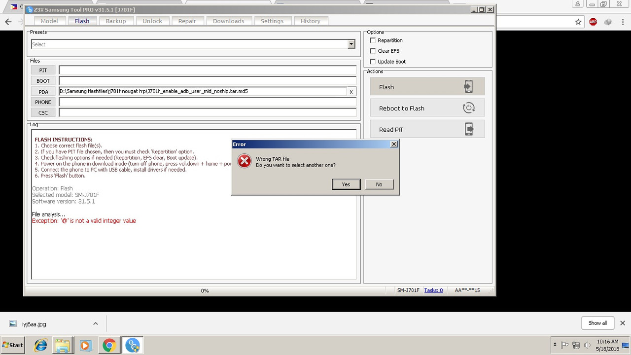

File analysis...
Exception: 'G' is not a valid integer value
Done with Samsung Tool PRO v.29.9
why kaya bakit ganyan...
boss salamat sa reference pero ganito po ang error
File analysis...
Exception: '@' is not a valid integer value
Done with Samsung Tool PRO v.30.5

File analysis...
Done with Samsung Tool PRO v.30.8
