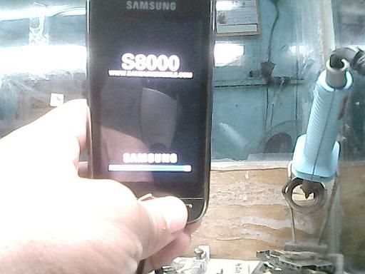

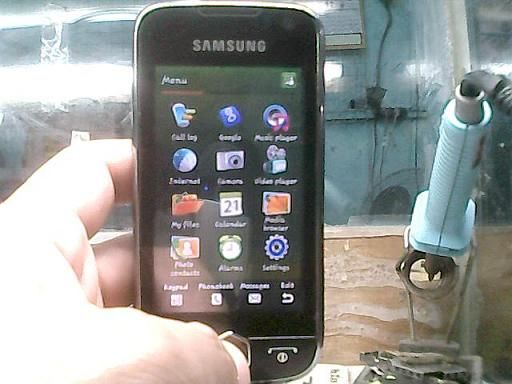

DISMANTLE S8000

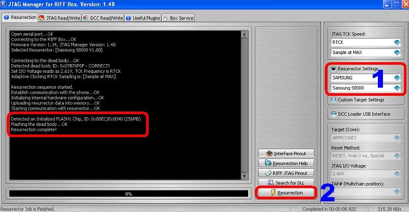

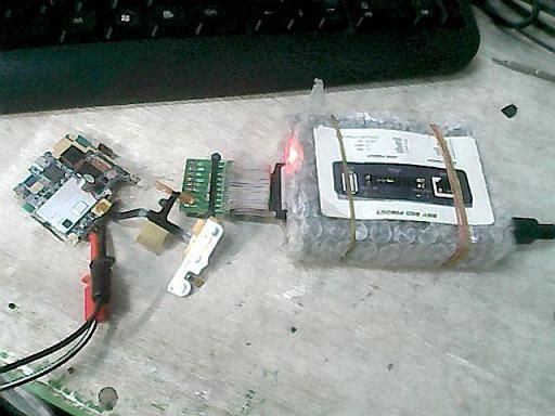

To resurrect a dead Samsung S8000
Solder JTAG cable to S8000 JTAG pads
Make sure Samsung S8000 is selected in the list of models
Inset battery, press and hold down the Power-on button
Click Resurrection button; please note, until software signals detected device do not release power button
Resurrection sequence starts flashing the phone memory
Software will signal successful operation completion
De-solder JTAG wires
