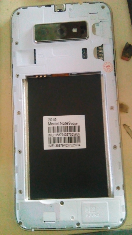

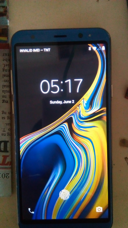

samsung note 9 edge clone walang signal, invalid imei kasi hindi kaya sa hard reset.

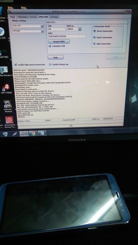

open nck dongle crack
select phone settings to MT650
select IMEI UTILS
enter valid imei for IMEI1
select repair imei
power off the phone and insert usb wait until done
(for sim 2, same procedure parin)

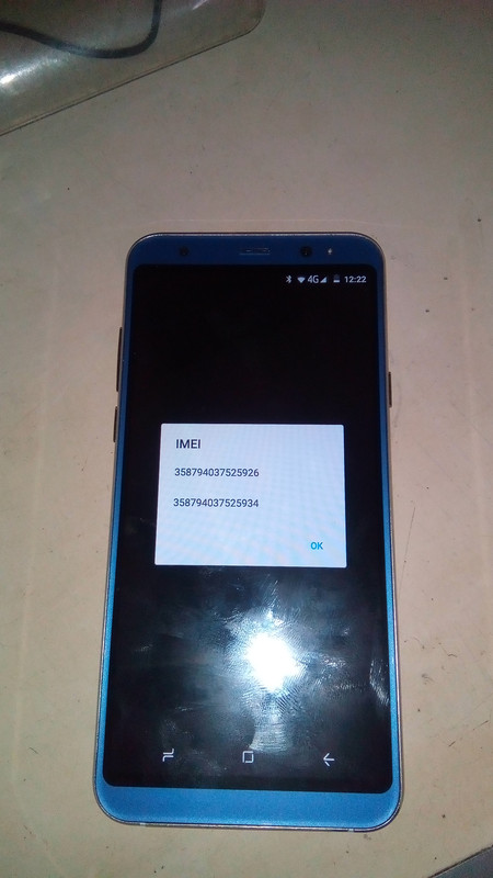

SIM 1
SIM 2

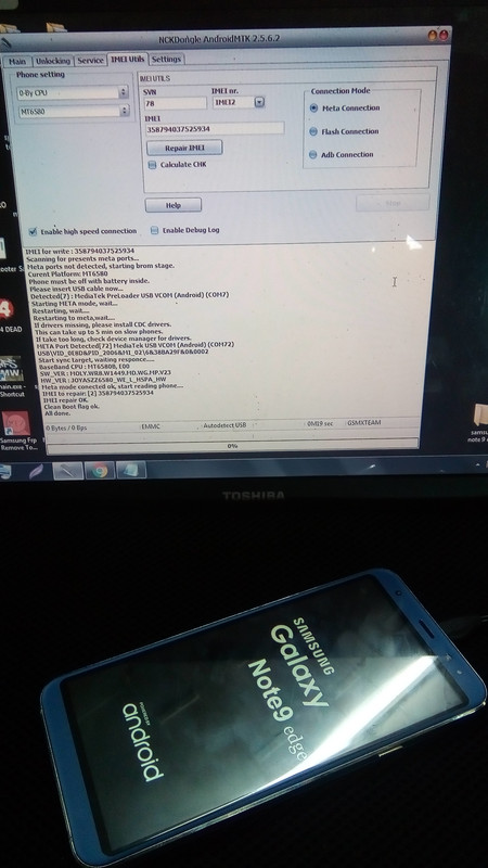

select IMEI UTILS
select repair imei
SIM 1
SIM 2
