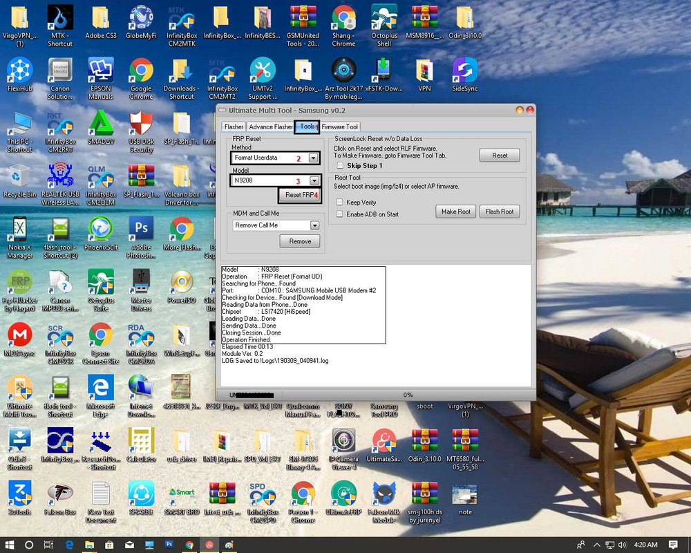

PROCEDURE:
1. Power Off Phone
2. PRESS and HOLD home, volume down and power!
3 After that you see on screen press button + volume to download mode
4. Then click tab RESET FRP
5. Insert USB cable
6. wait until finish done
