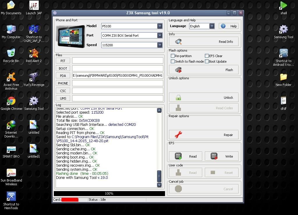

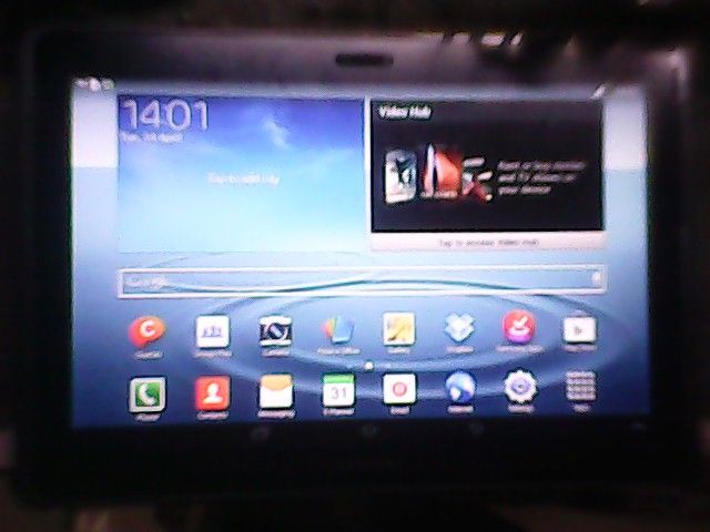

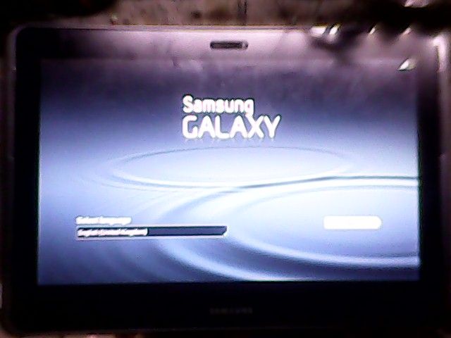

gud pm po mga boss share ko lang po as refference itong kakagawa ko samsung p5100 stock lang po sa logo ng na tanggap ko na e flash daw ng may ari kasi update daw nya kaso nag failed kaya na stock sya sa logo
Download this firmware
http://www.4shared.com/get/bOaIhquh/Official_rom_GT-P5100_France_P.html
PROCEDURE:
Fully turn off tablet using hold power on button
press down and power to download mode
connect usb to tab isntall driver
put fimware to z3x tool
click flash
and wait to finish
SOME OF MY SCREEN SHOTS:....
ayan done na po sana makatulong pag pasensyahan nyo na lang ang screen shots ko medyo malabo...:D:D

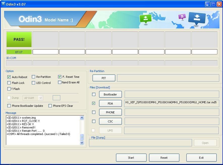

ok lang poh ba odin gamitin ko pang flash nito gamit firmware mo?
yup boss swak na swak parin yan sa odin 3.07
load firmware sa PDA tab then click start and wait for few minutes
sample screenshots using odin
