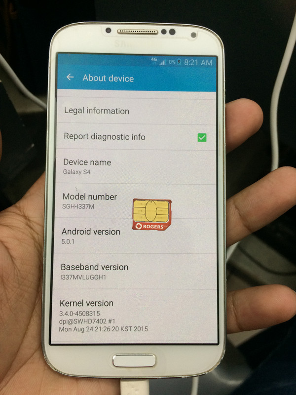

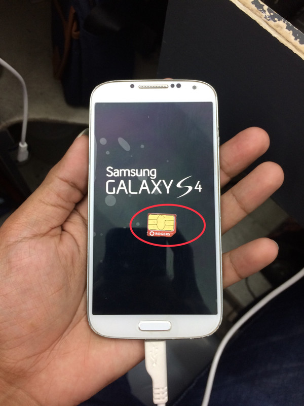

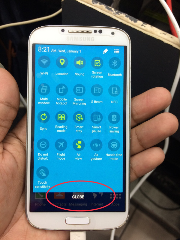

Samsung s4 History;humihingi code galing canada kaya
proceed ako unlock

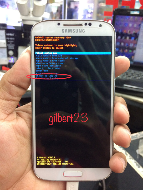

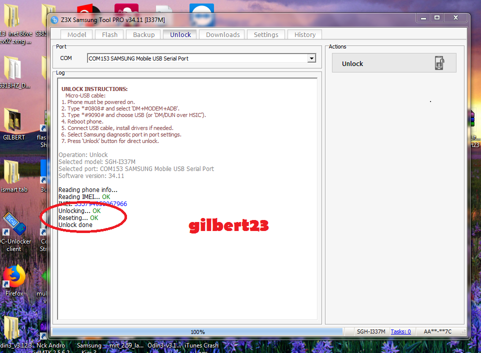

Procedure;open z3x pro
open phone device setting
tap build number 3x
pagkatapus open develover and debug
dial *#0808# select-DM+MODEM+ADB
pagkatapus/pa recovery phone(Enable cp logging)
kasi pag hindi naka enable ang cp logging lumalabas(not recognized)
happy installing drivers
share kulang baka maka tulong sa mga new member gaya ko
