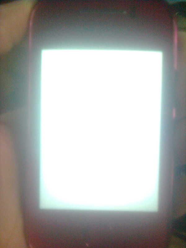

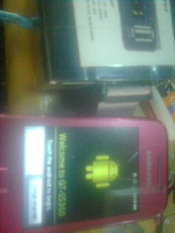

samsung s5360 white screen done via riff box

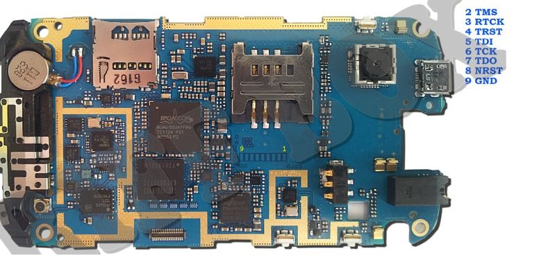

Resurrecting Samsung S5360 is easy. To power the phone connect USB cable and insert battery. Sometimes it’s needed to press Power On key.
In case phone is not detected de-power phone completely, then wait few seconds, insert USB cable and then insert battery.
To resurrect Samsung S5360:
Ø Solder JTAG cable to Samsung S5360 JTAG pads;
Ø Connect USB cable to phone and PC;
Ø Insert battery;
Ø Make sure Samsung S5360 is selected in the list of models;
Ø Click Resurrect button;
Ø Wait till software signals a successful operation completion;
Ø Disconnect USB cable, de-solder JTAG wires;
Now phone is in bootable condition, that is, even if it does not start up normally, you can flash it using original Samsung downloader software to restore it to the working state.
To enter download mode:
v Disconnect PC cable;
v Insert battery;
v Hold both ‘Volume Down’ and ‘Menu’ keys and press Power-On.
v If nothing happens, try an alternative: hold both ‘Volume Up’ and ‘Menu’ keys and press Power-On.
Most common errors:
v The NRST signal is not connected. Pease ALWAYS SOLDER THE NRST SIGNAL whenever it is present on the schematics. In case you have JIG please make sure NRST is routed, if not - solder wire manually.
v Connection is unstable or cannot be established at all. Please make sure JTAG wires are of the SAME LENGTH and total length of each wire not exceeds ~10...15 cm; make sure a fixed TCK frequency is selected (since device has no RTCK signal)

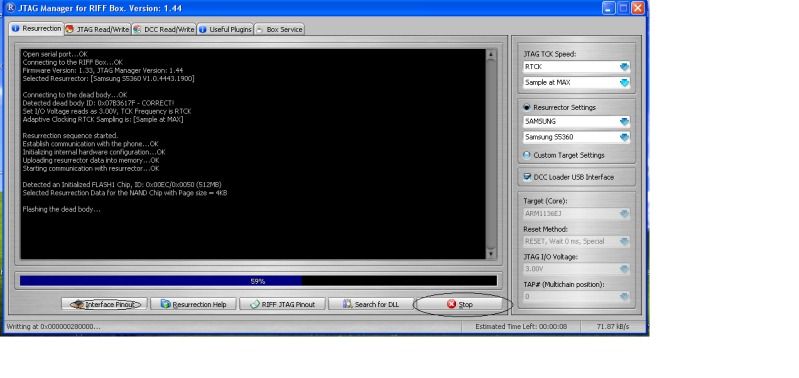

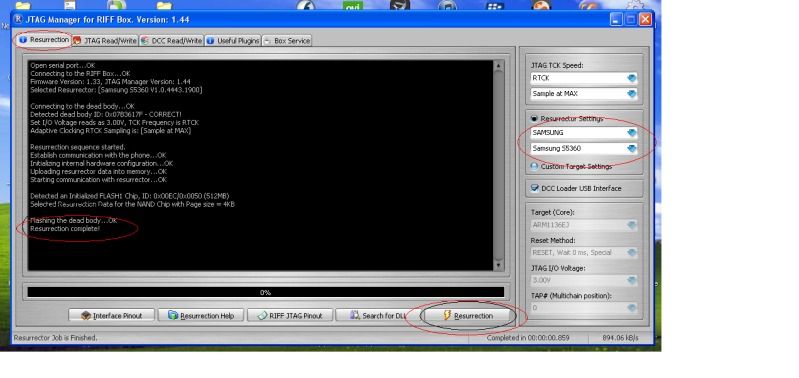

here working
Open serial port...OK
Connecting to the RIFF Box...OK
Firmware Version: 1.33, JTAG Manager Version: 1.44
Selected Resurrector: [Samsung S5360 V1.0.4443.1900]
Connecting to the dead body...OK
Detected dead body ID: 0x07B3617F - CORRECT!
Set I/O Voltage reads as 3.00V, TCK Frequency is RTCK
Adaptive Clocking RTCK Sampling is: [Sample at MAX]
Resurrection sequence started.
Establish communication with the phone...OK
Initializing internal hardware configuration...OK
Uploading resurrector data into memory...OK
Starting communication with resurrector...OK
Detected an Initialized FLASH1 Chip, ID: 0x00EC/0x0050 (512MB)
Selected Resurrection Data for the NAND Chip with Page size = 4KB
Flashing the dead body...OK
Resurrection complete!
done
