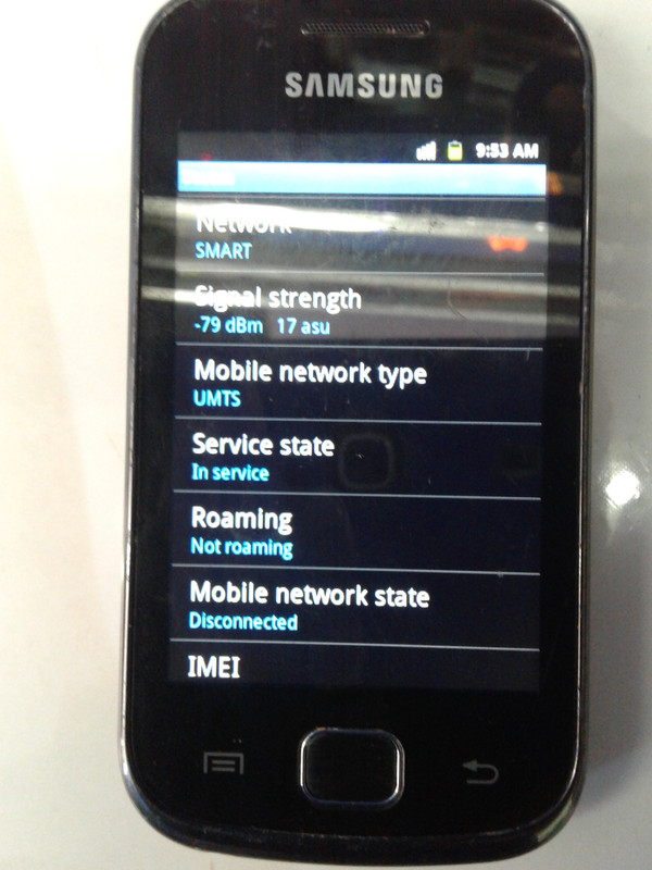

samsung s5660m unlock done kay Z3Xpro
old is gold
ito po yung procedure sa usb ko sinalpak

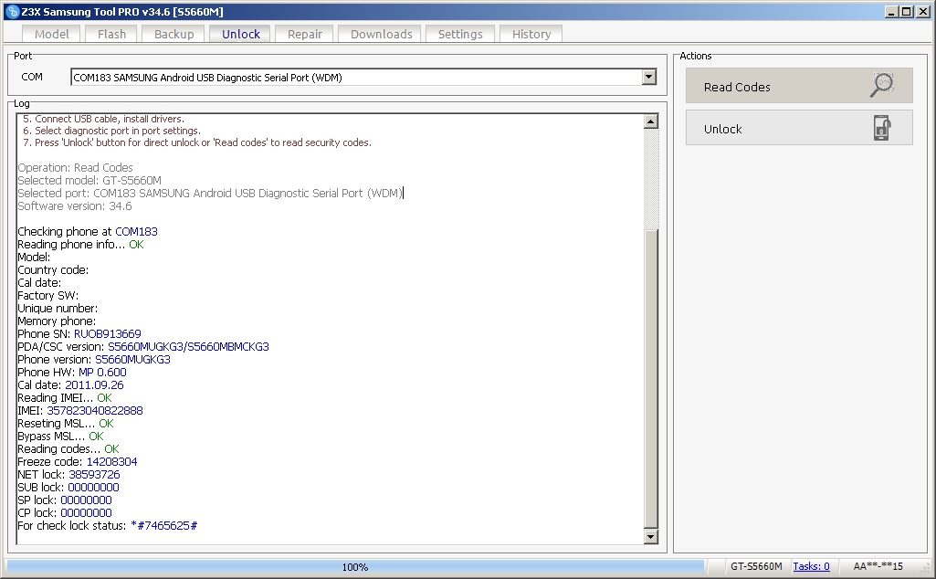

tapos unlock sa Z3X
USB cable:
1. Phone must be powered on.
2. Type *#7284# and choose phone USB.
3. Type *#197328640#, select: Common - Diag Config - USB diag.
4. Reboot phone.
5. Connect USB cable, install drivers.
6. Select diagnostic port in port settings.
7. Press 'Unlock' button for direct unlock or 'Read codes' to read security codes.
tapos unlock sa Z3X
