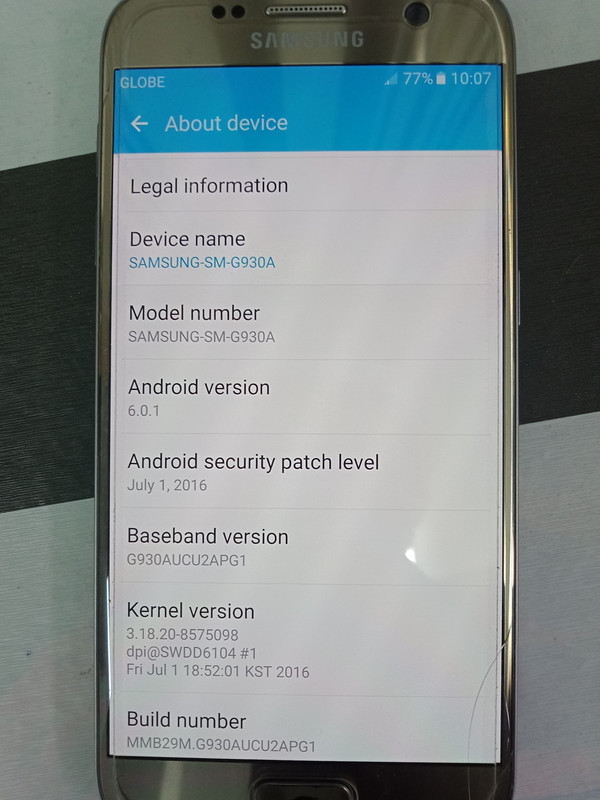

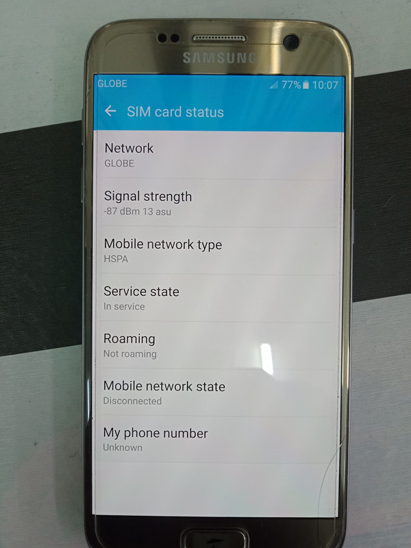

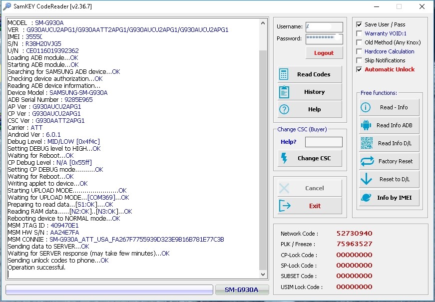

andreivi Expired Account Joined Jul 30, 2014 Messages 1,986 Reaction score 271 Points 381 Location Sison, Pangasinan/ Rosario, La Union Dec 2, 2019 #1 share lang mga boss Samsung G930a Unlock done sasamkey enable usb debugging dial *#0808# select DM-Modem-ADB insert usb open Samkey Login account 3 Credits needed Click Read Codes antayin matapos done
