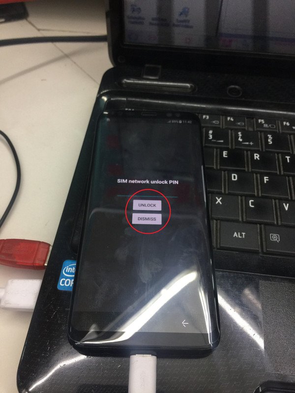

lumalabas unlock code galing ibang bansa
Action:

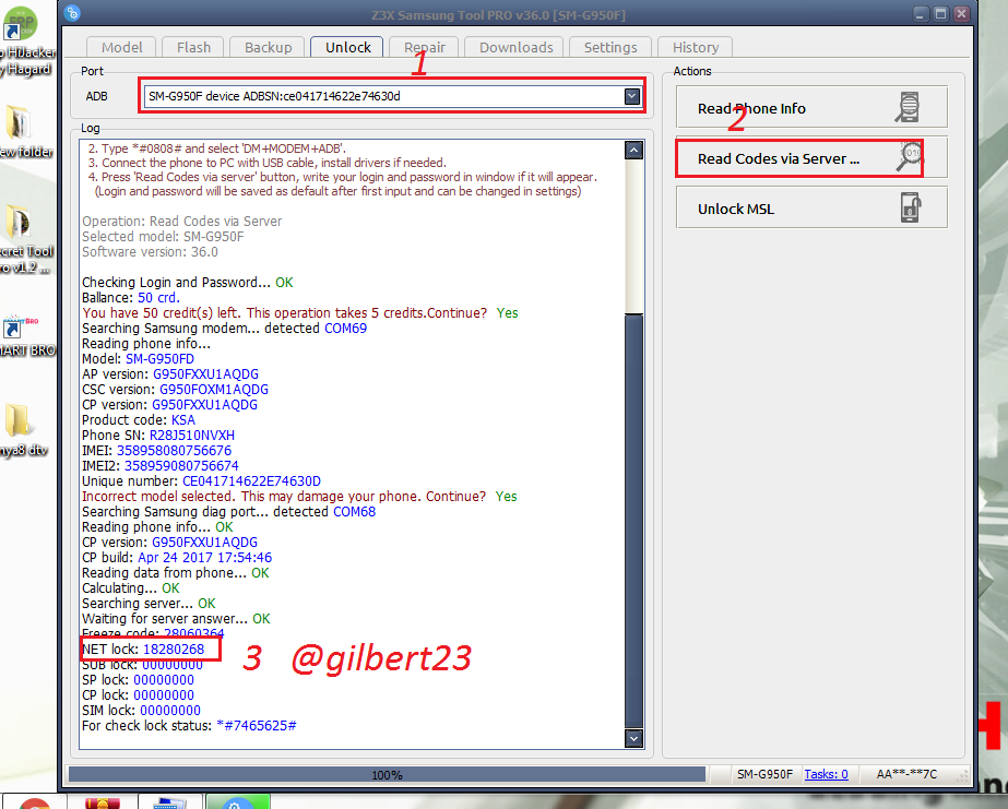

Open z3x
select phone model
click read codes
wait until done

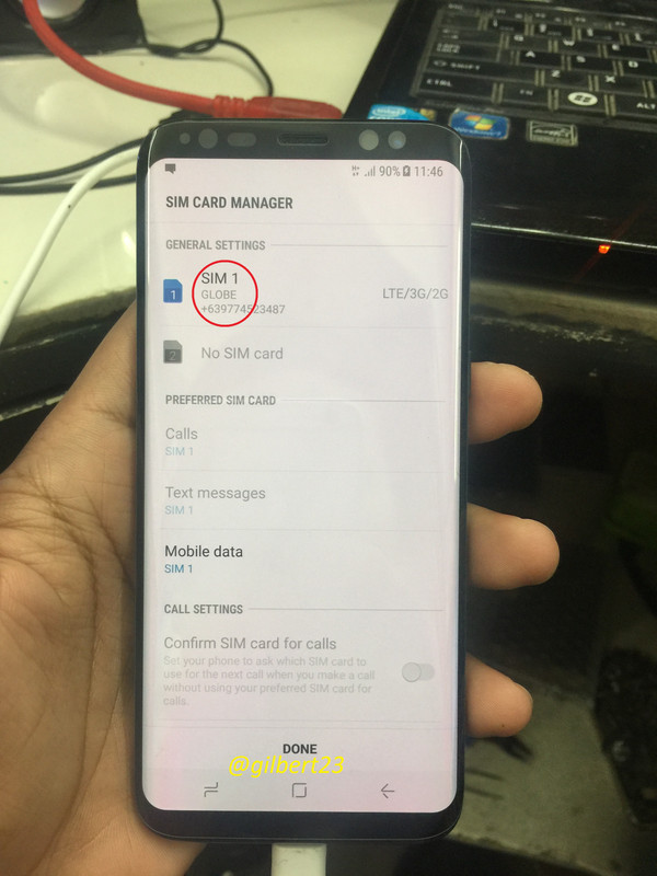

all done smile
hit like kung naka tulong salamat sa pag view
