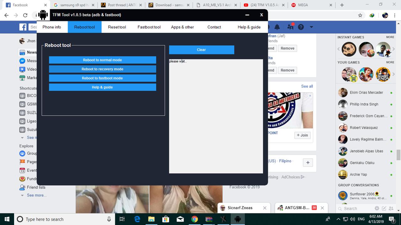

at e2 na po mga gagawin
the open tfm tool
dpat naka open unit po

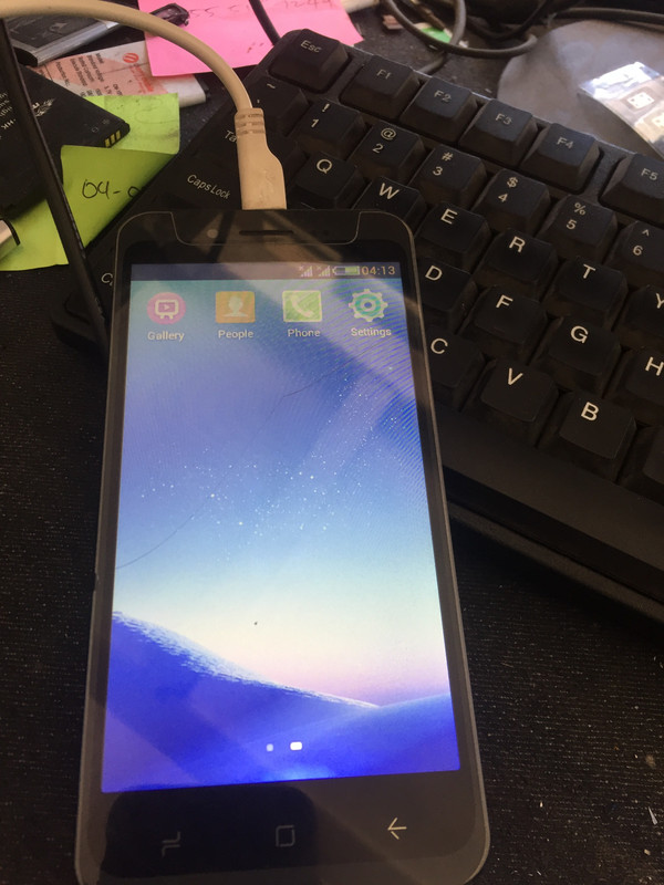

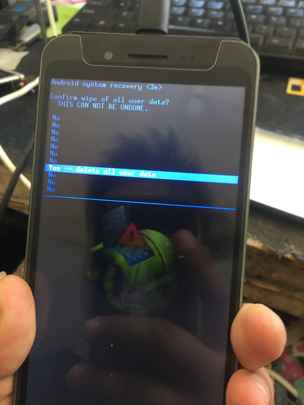

Tas hit recovery mode
yan n llbas alam n ggwin po
At done e2 na po
sana makatulong po
