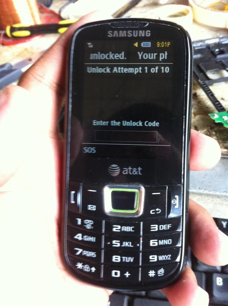

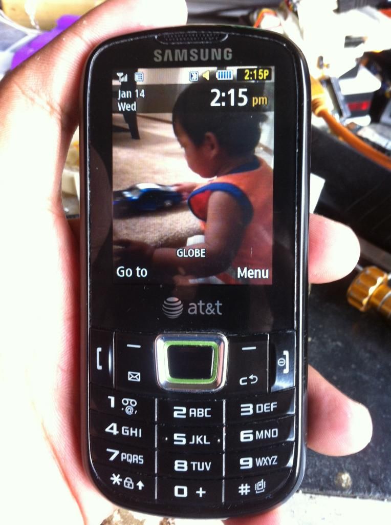

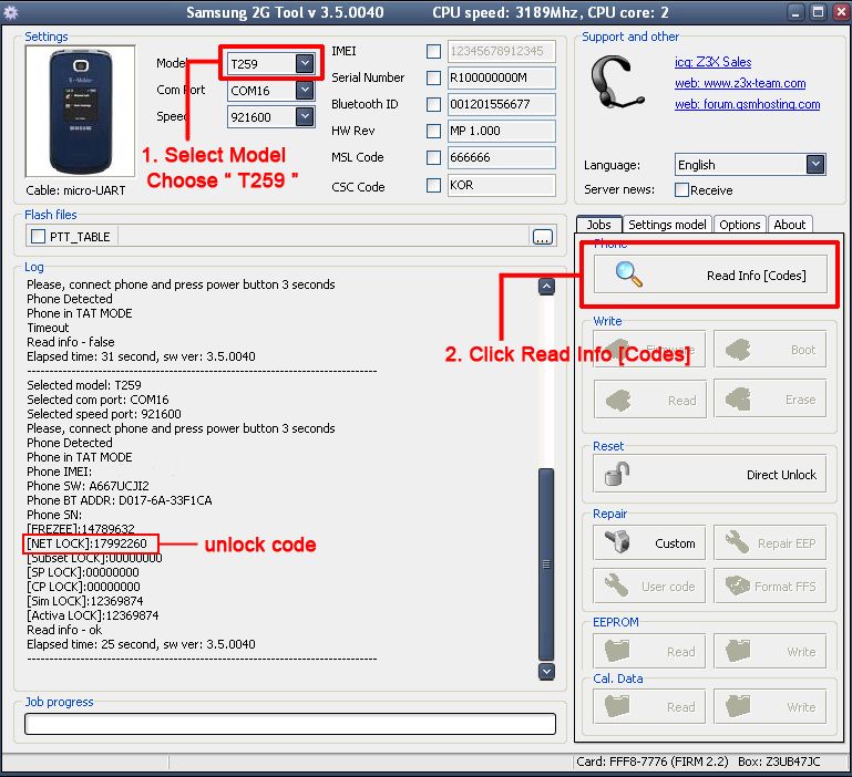

B BLIND Registered Joined Dec 23, 2014 Messages 2,965 Reaction score 14 Points 381 Location manila Mar 20, 2015 #1 SAMSUNG SGH-A667 unlock done..[Reference] Samsung SGH-A667 at&t locked, Procedures: 1. Open Samsung 2G Tool 2. Select Model choose " T259 " 3. Click Read Info [Codes] (use micro uart cable) 4. Open phone with unaccepted Simcard. 5. Enter Unlock Code
