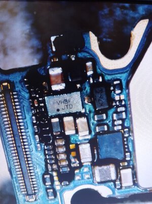

Phone Status:
No power
Not Charging
Action taken:
✅Check battery voltage reading
= 0 reading
✅Shock Battery using PSU
= 2.7v
✅Removed Battery and charge
✅Use iBoot cable para macheck kung Buhay pa Ang board
= Buhay pa Ang Board
✅Binalik ko na sa phone Ang battery after macharge sa battery charger
✅Saksak battery charge at ayaw mag charge. test battery terminal king may reading pero walang voltage reading.

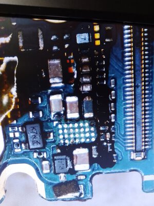

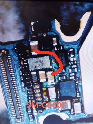

✅From Charging pin, trace ko possitive line at umabot sa OVP(Over Voltage Protection) IC may input pero walang output.
Solutions:
PWD RIN JUMPER(REFER PIC)
