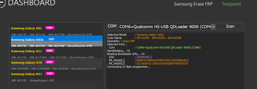

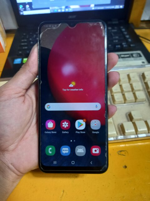

Share ko lang po gawa ko na Samsung A02s na Naka lock sa google account o FRP( Factory Reset Protection)
dahil ni reset ni tomer na naka password.
Una kinausap ko si tomer na kailangan buksan ang unit para ma detect ng computer
at pumayag naman po ito.
TOOLS:
Tweezer
Usb Cable
Pc or Laptop
FRP Samsung Qualcomm [yohan - Labs] (FREE)
pass: gsmVNtool
Driver if needed:
Qualcomm_HS_USB_QDLoader_9008_Driver

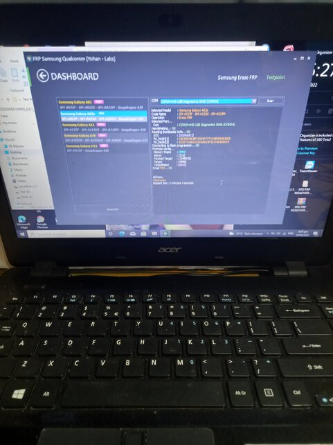

Procedure:
1.Open FRP Samsung Qualcomm [yohan - Labs]
2.Select Model Samsung A02s
3.Testpoint unit (Disconnect battery) insert usb cable and tick scan port
4.Then Tick Erase FRP
Done in 3 seconds
Sana po makatulong.
