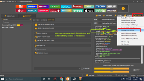

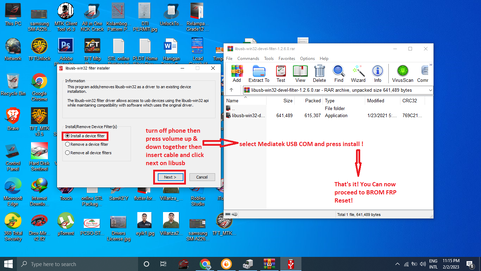

1st install muna natin yong LibUSB Driver na nasa unlocktool na mismo para hindi mag error yong Authentication Bypass!

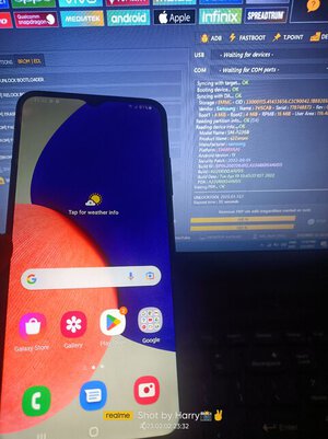

nasa pic nayong procedure..

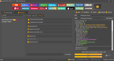

For FRP Reset:
Choose samsung then select SM-A226B model then choose [BROM] ERASE FRP
turn off phone then press volume up and down together then saksak mo usb sa pc.. done!
