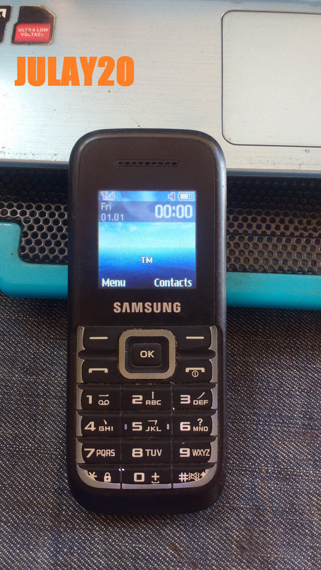

post ko lang mga boss naka lock sa smart ito ginawa ko

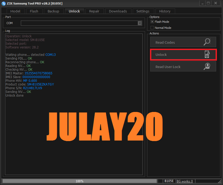

open z3x box mas ma inam kong meron ka pero ang ginawa ko ginamit ko tool yung crack ko na z3x
off unit laging silipin kong my driver yung unit para sa pc o loptop pindotin yung 1 at ok button click unlock done
ito ss ko
info
done sana maka tolong

Code:
Operation: Unlock
Selected model: SM-B105E
Selected port:
Software version: 28.2
Waiting phone... detected COM13
Sending FDL... OK
Reconnecting phone... OK
Reading NV... OK
Checking NV... OK
IMEI Master: 352554070758065
IMEI Slave: 000000000000000
Phone HW: MP 0.600
Product code: SM-B105EZKATGY
Phone S/N: R21H817LV9
Sending NV... OK
Unlock done
Done with Samsung Tool PRO v.28.2
