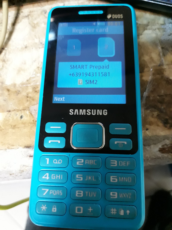

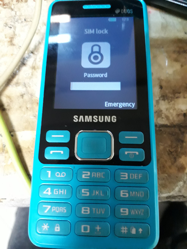

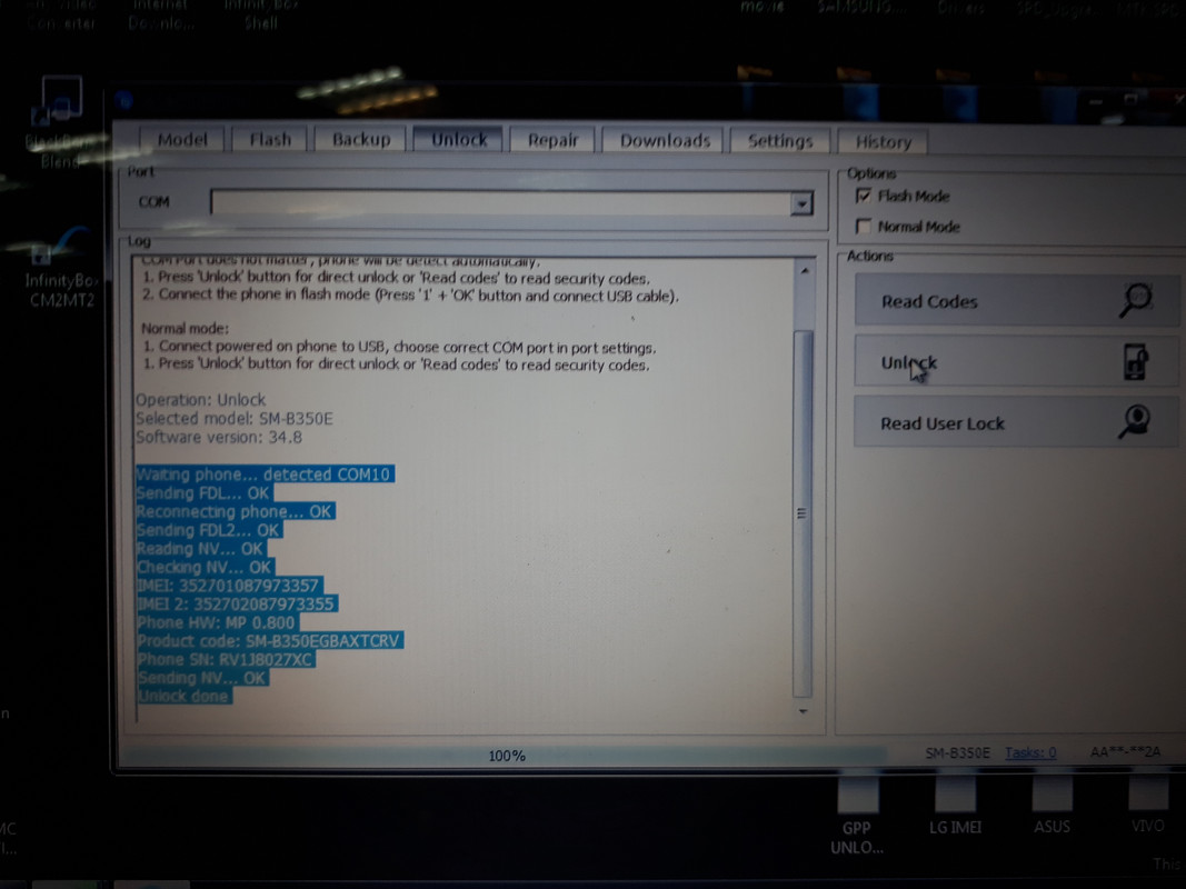

GOODMORNING MGA KA ANTTECH SHARE KO LANG TONG PHONE NA MAKUNAT E UNLOCKED.DIRECT UNLOCKED AND READCODE KO NA SA Z3XBOX GANUN PARIN SIMLOCKED PARIN..TRY KO NA TYPE "12345678" BIGO PARIN..KYA GINAWA KO

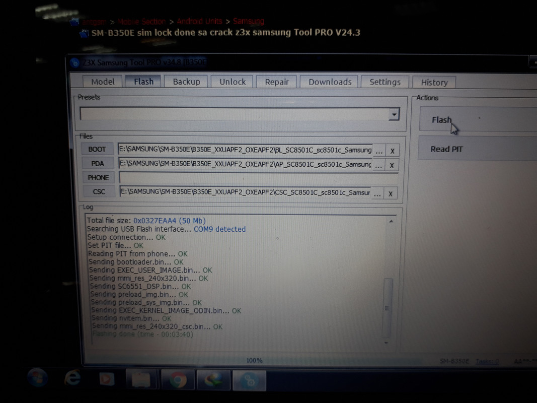

FLASHING SA TESTED FIRMWARE WALA NMANG MAWAWALA BASTA WALANG KABA.

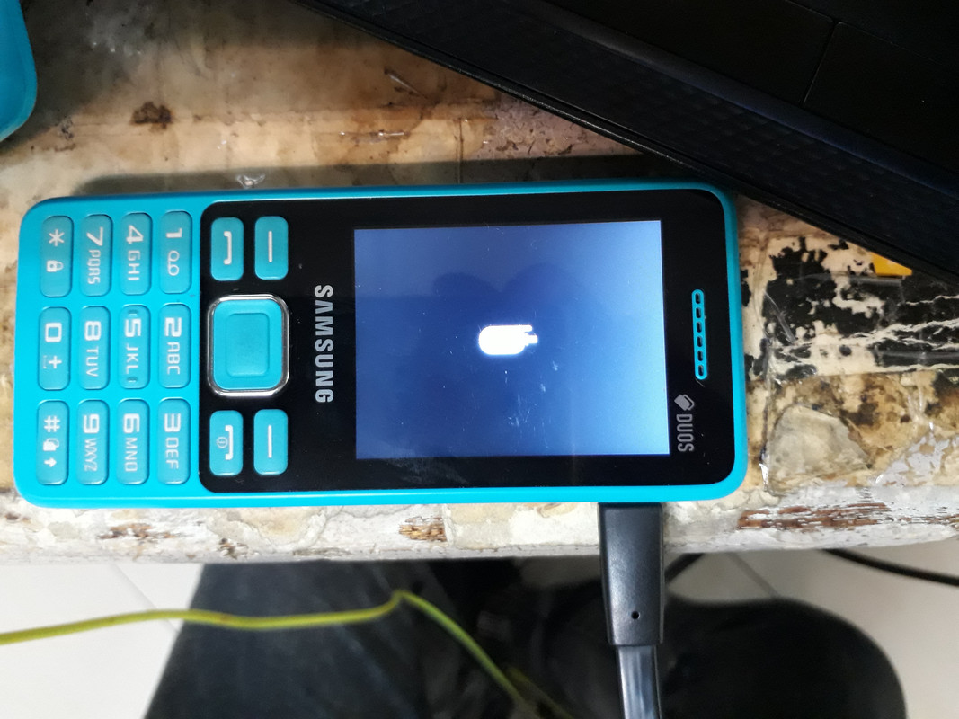

OPEN Z3XBOX.
PRESS "0" + POWER BUTTON
INSERT USBCABLE
FIRMWARE HERE..
https://www.4shared.com/zip/kLbWyZv4ba/B350E_XXUAOI1_OXEAOI1.html
DONE SANA MAKATULONG SA TAHANAN..
