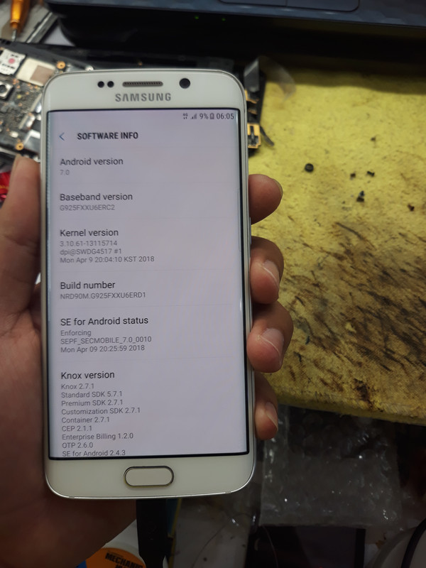

TOOLS
<Z3X PRO
<OTG CABLE
<MEMORY CARD

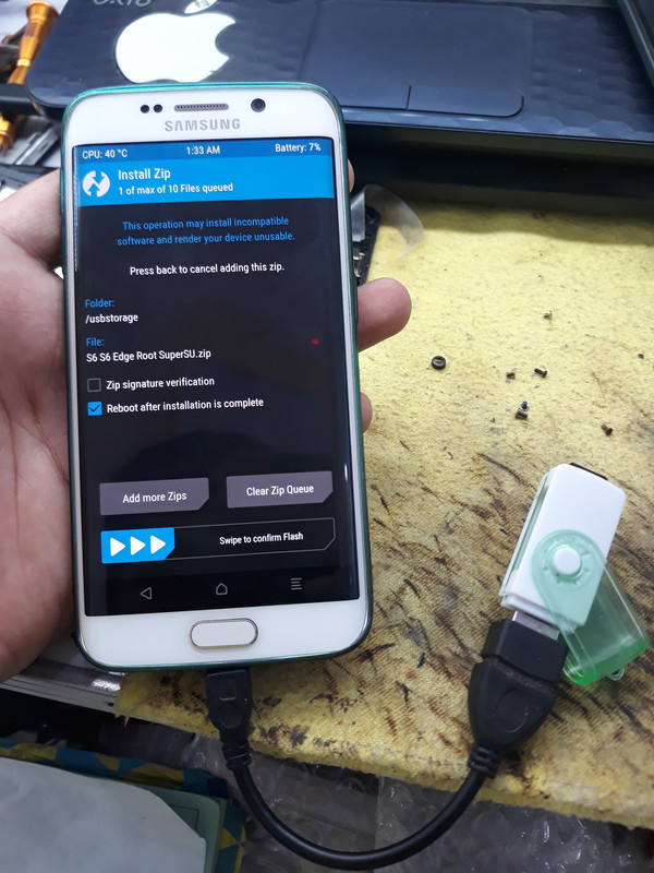

AT ITONG MGA FLASH FILES https://www.mediafire.com/file/6tteojer213nsm8/S6_S6_Edge_Root_SuperSU.zip/file
https://www.mediafire.com/file/0gl0c88j30megz7/twrp-3.0.2-0-zerolte.img.tar/file

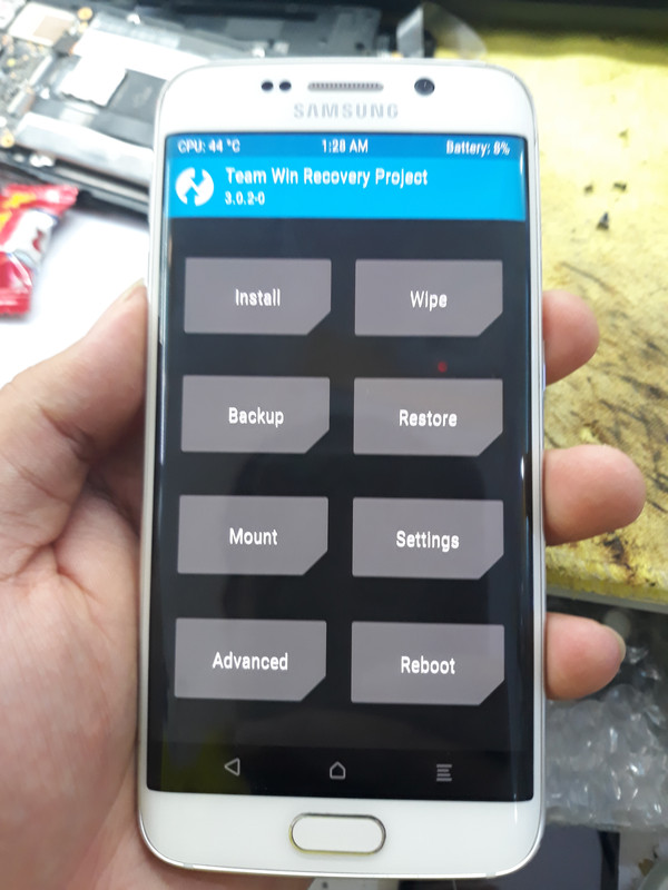

1> FLASH POH USING ODIN
https://postimages.org/app

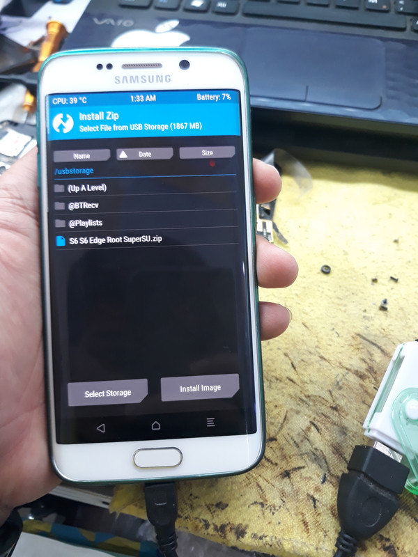

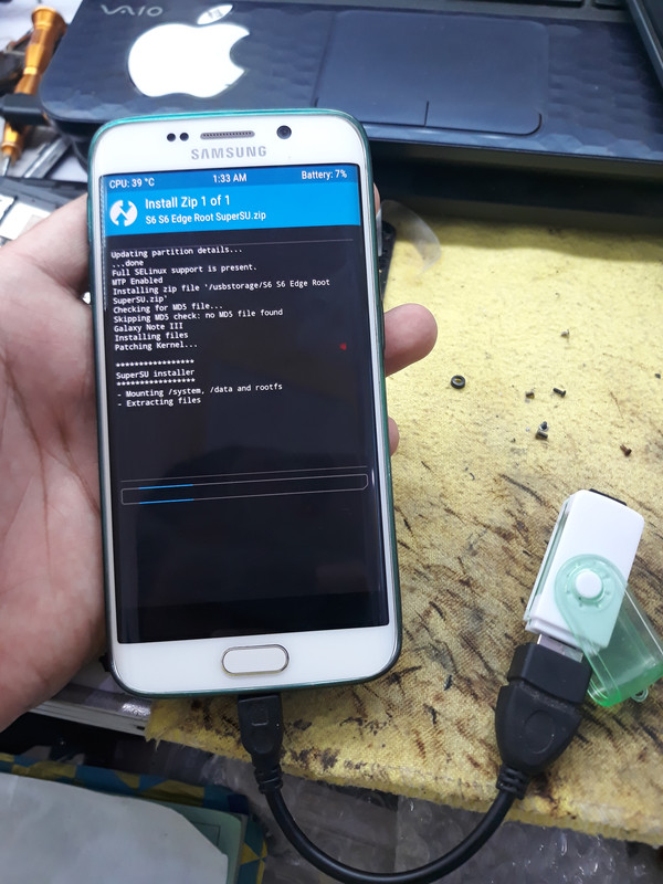

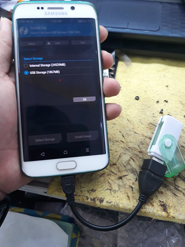

2>INSTALL ROOT FILE

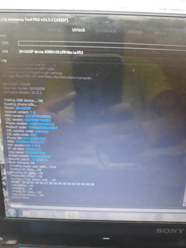

>3 UNLOCK Z3X (SORRY NAKALIMOTAN KO PRINT SCREEN HEHEHE)

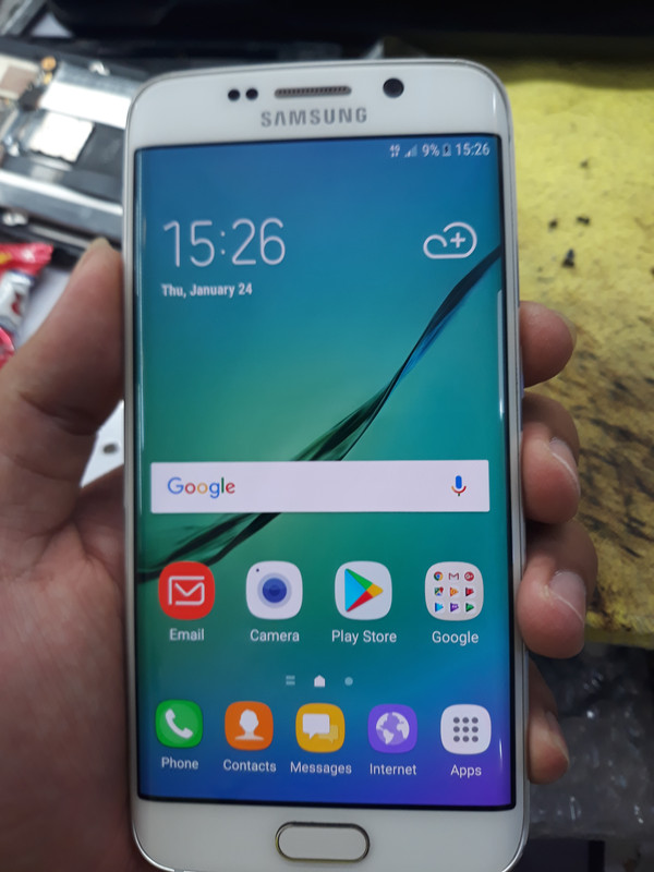

FINISH
SANA MKATULONG...
