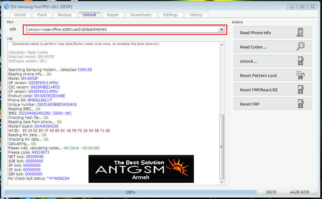

Magandang hapon po mga boss, share ko lang po
tong tanggap ko, for Reference Purpose Only.
Model:
Samsung SM-G935F v6.0.1
Security Patch Level:
May 1, 2016
Proceedure:
Phone must be Powered ON
First Enable USB Debugging, ( to enable, go to settings - About Phone
- Look for Build Number, tap 7 times until, Developer Options
Appear, then turn ON also OEM Unlocking.
Next Open Z3x Samsung Tool Pro v28.1
Choose Correct Model ( SM-G935F ) Then, Insert USB cable
to phone.
Go to Unlock Tab, Wait for the ADB ( Android Debug Bridge ),
( Drivers must be Installed ) then select ADB.
Tick Read codes ( sa akin po, pinili ko po ay read codes yung old
kase May 1, 2016 po, Sec. Patch Level nitong Tanggap ko ).
Wait Until Done!!!
Lastly Insert Unsupported Sim on the Phone ( Globe, Smart, etc. )
Hihingi po yan nang Codes.
Enter First Freeze Code, and Next The Net Lock code.
Done...
Ito po Screenshot:
