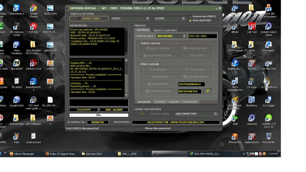

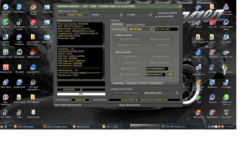

dinala sa akin ipapa unlock daw po pero check ko pag on hang lang sya hindi tumuloy sa menu.
PROCEDURE:
1.open latest vygis shell
2.select model
3.check (auto find port)
4.power on phone conect v804 cable kahit hang madedetect parin.
5.press conect button
6.hit factory reset! wait until reboot Done!
7.sa unlocking press direct unlock lang.
factory reset Done!
