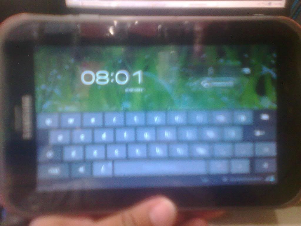

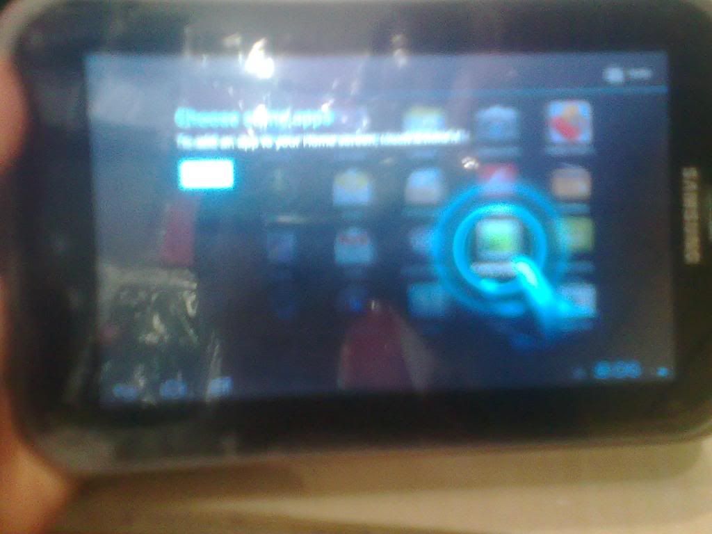

May password nakalimutan ng may ari.... done by hard reset...

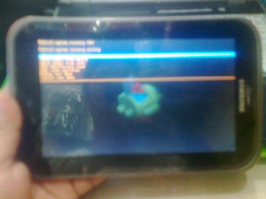

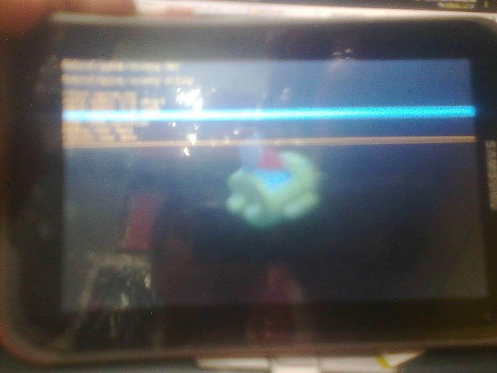

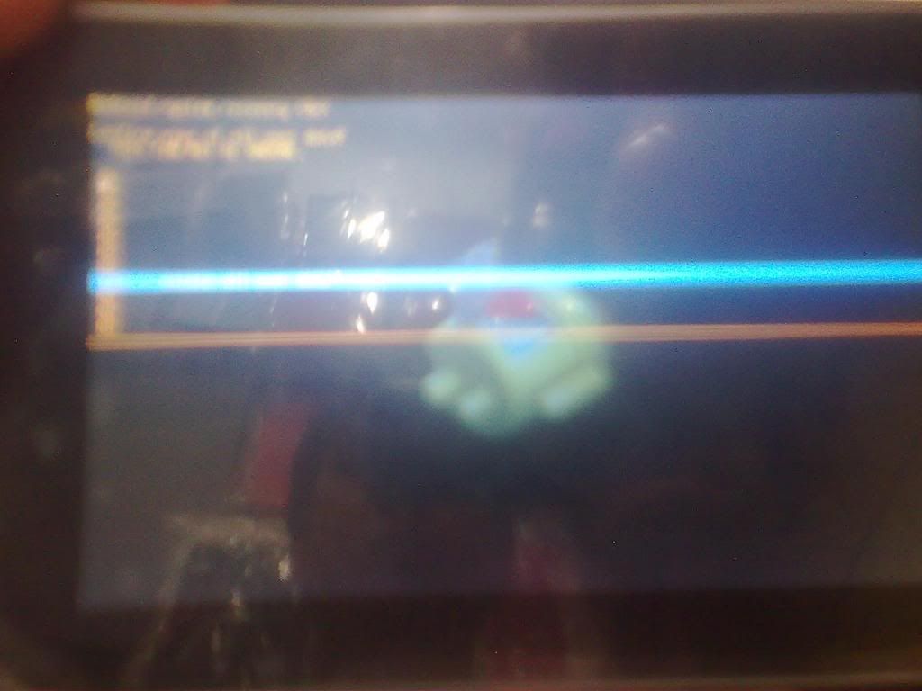

Procedure:

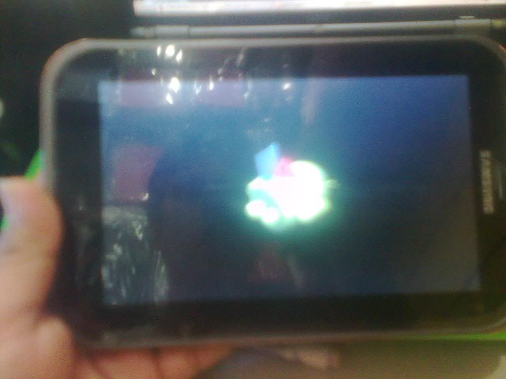

1. Press Power Key for 3 seconds, then press Vol - key...

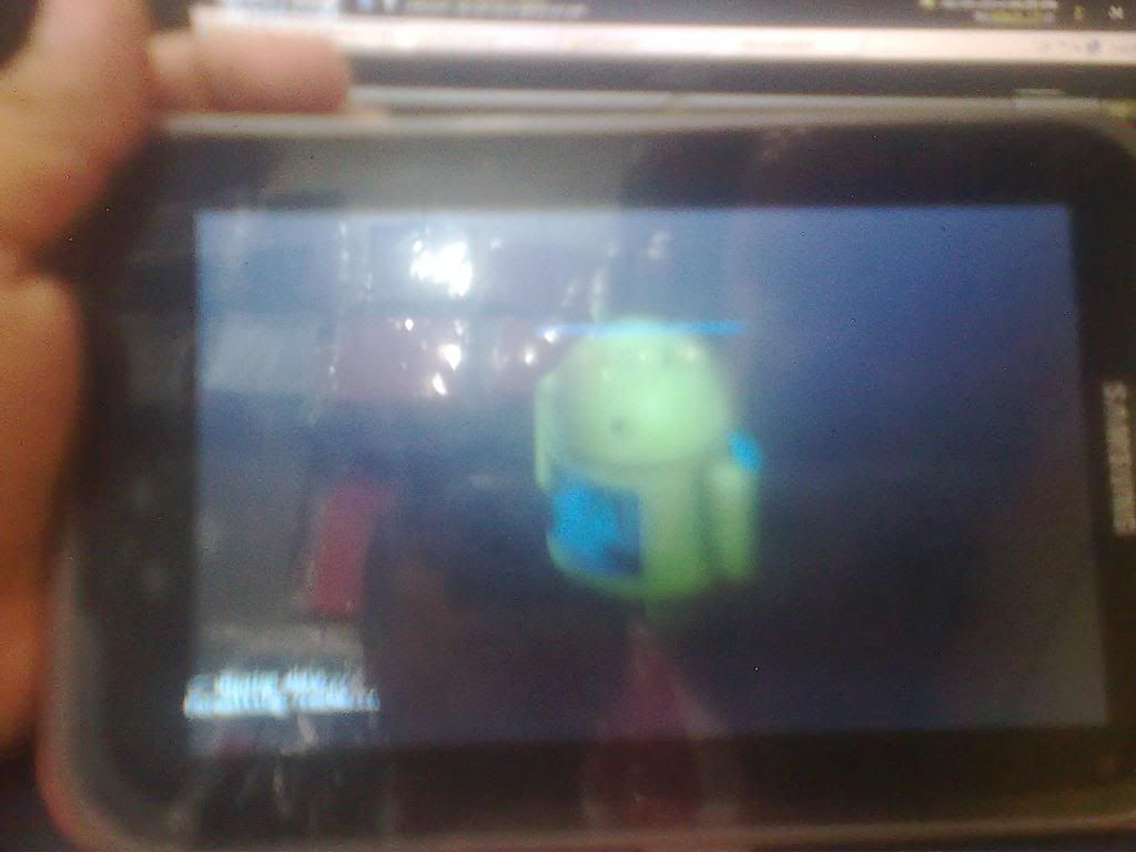

2. Lalabas ang Android with exclamation mark...
3. Press Power Key once para lalabas ang Recovery...
4. Press Vol - to navigate selection and Vol + to choose...

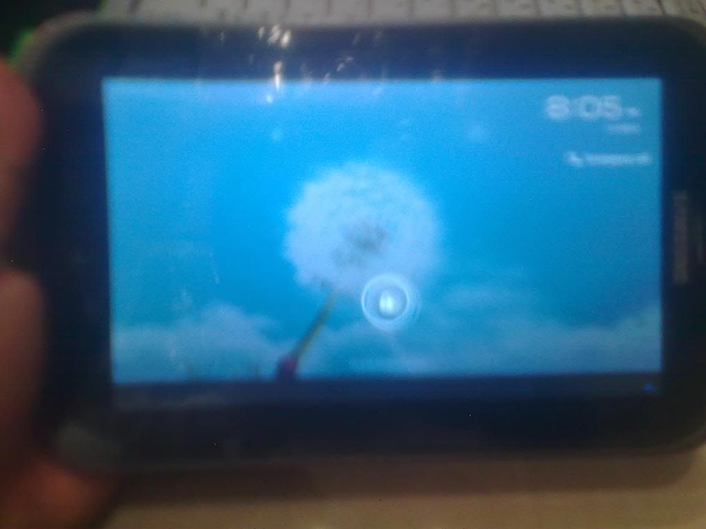

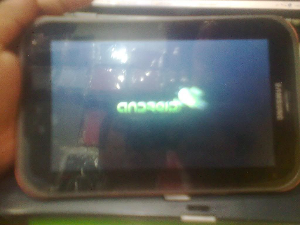

5. After wiping, reboot tablet...
6. Done... :D:D:D
