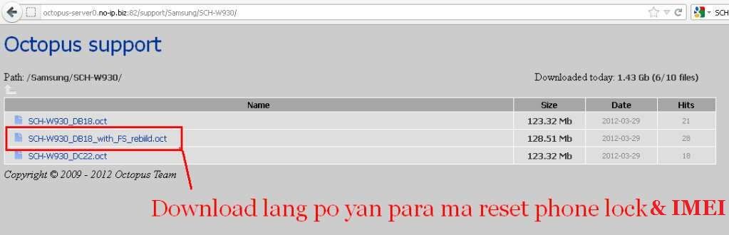

2- Goto support DL firmware (SCH-W930_DB18_with_FS_rebiild_2.oct) to reset phonelock & IMEI

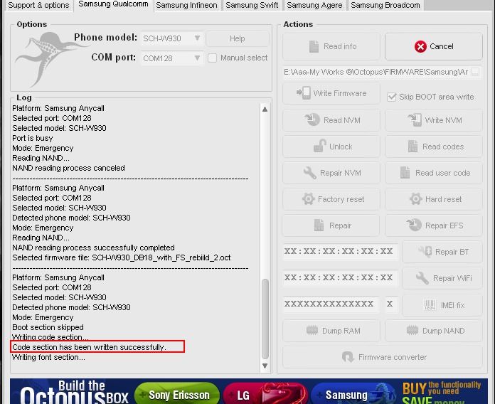

3- enter emergency mode ( press and hold 4 + power on)
4- put firmware and press write firmware make sure na fully charge ang battery

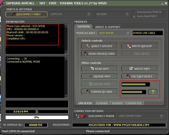

SCREEN SHOT

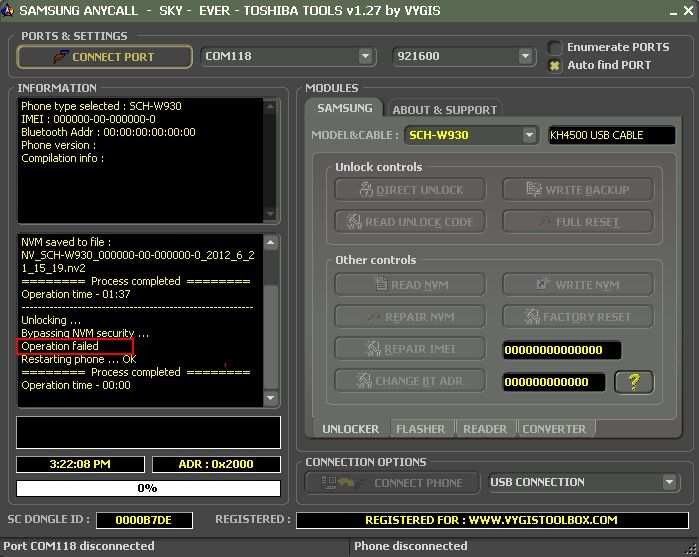

ito unang info
try ko unlock pero failed

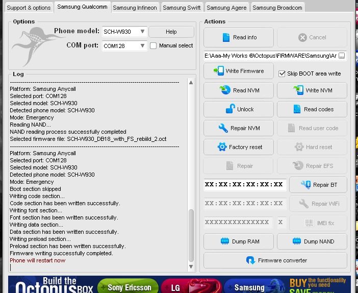

kaya try ko flash sa vygis baka sakali pero no luck walang nabago at ndi na reset.
Download firmware from octopus support

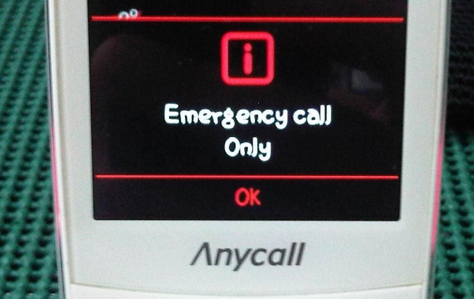

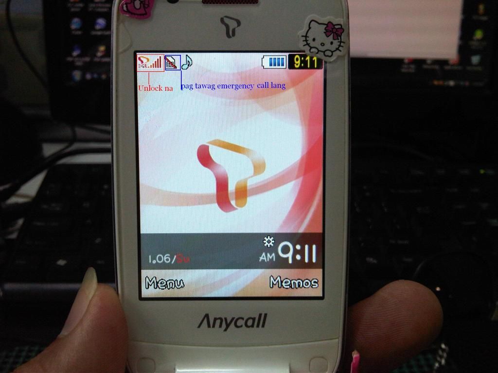

after unlock on Octopus hindi makatawag emergency call only

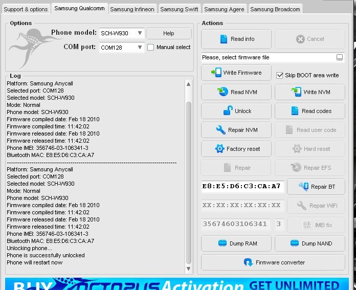

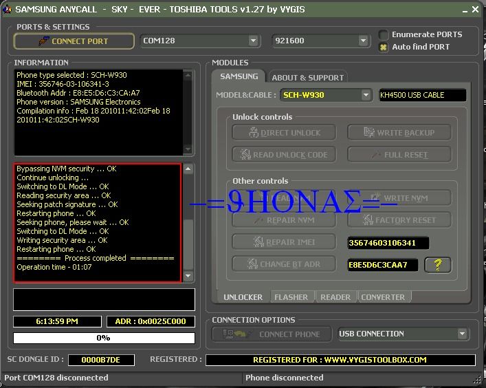

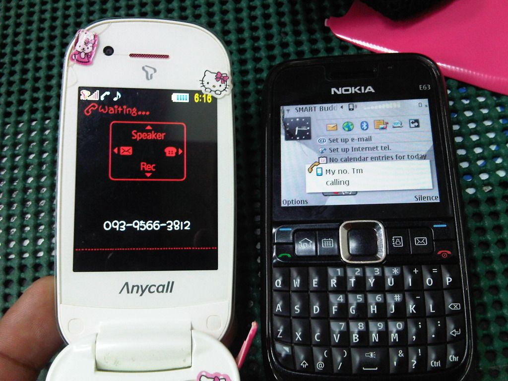

ok na ang IMEI after flashing sa Octopus kaya unlock ko ulit kay vygis

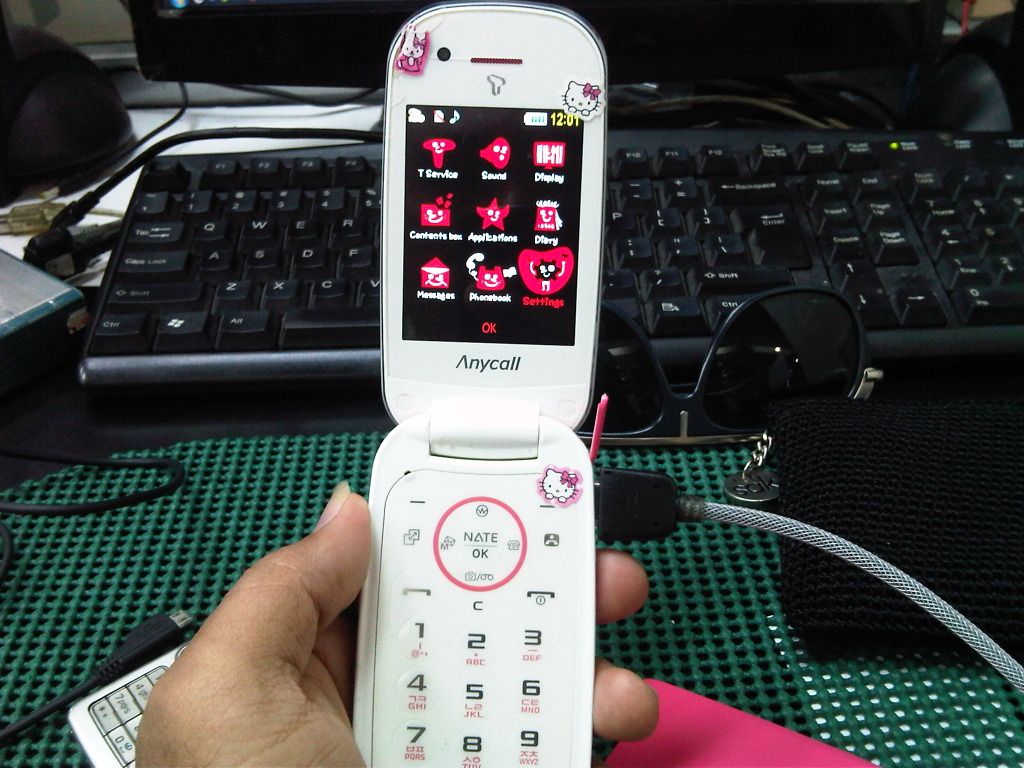

kay vygis din nagtagumpay ayan nakakatawag na
ito unang info
