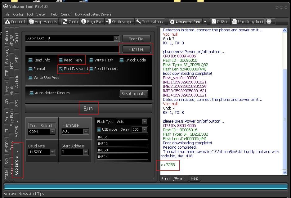

manila
skk buddy cread flash/code! by volcano
unit : skk buddy
problem : password protected
cpu : coolsand
action taken
disassemble unit
pin out cable : rj45 from old fbus cable
connect pinout to board (pin out location: under lcd flex)
read code by volcano
tools
volcano box
pin out cable
procedure
1. connect pin out
2. open volcano GUI
3. select coolsand tab
4. read flash and run ( save anyname)
5. open flash file ( select read filename)
6. thick find password
7. DONE
