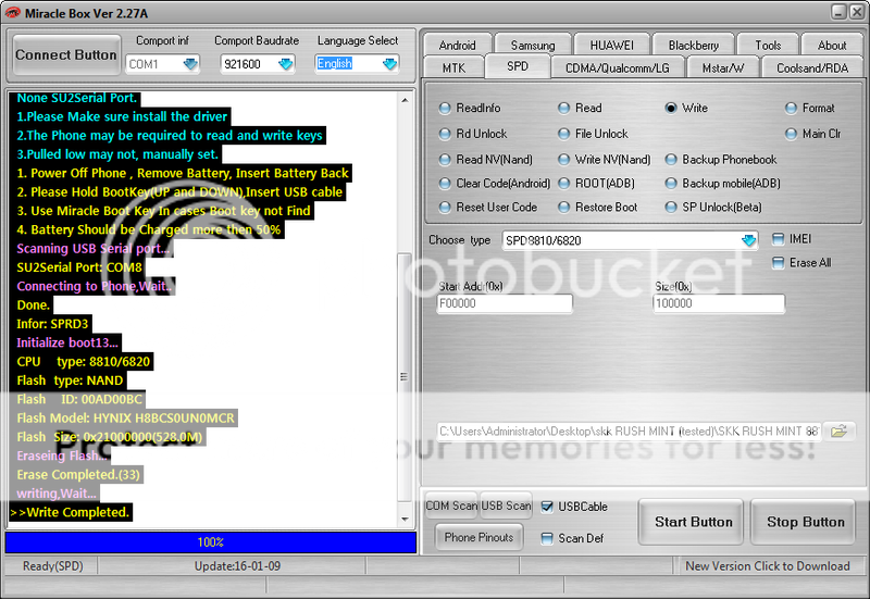

there are actually 3 firmwares available for each chips....
always read the info as to find which Firmware to use
in my case.. i received a unit whose opening but shows no display hence the micron type is what i used to flash since it was flash previously from other shops .
:clap
SKK_RUSH MINT_ BY_PRELOADER88_ 8810_6820_Samsung K9K4G16Q0M.rar
HYNIX B8BCS0VN0MCR
skk rush mint micron chip bin.rar
just in case hirap mag pa dtect try removing battery
then press power, up and down volume.. insert usb -then plug the battery
