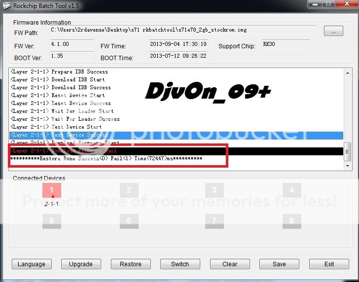

Problem
Hang on logo
Procedure
1.connect the tablet to computer
2.driver install located into rockchp tools 1.5.. folder driver
3.load img file s71factory
proceed to flashing;
how to detect:
ioff ang tablet
hold volume plus +
salpak ang usb
pag detect na click upgrade
wait lang matapos..
first attemp fail...
so ang ginawa ko binuksan ko...
at tinanggal yung battery, at saka binalik...

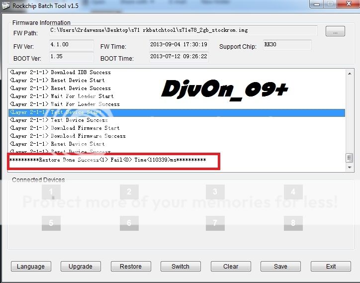

and try ulit....
ayun nag success din
stock rom S71
flasher rktool
