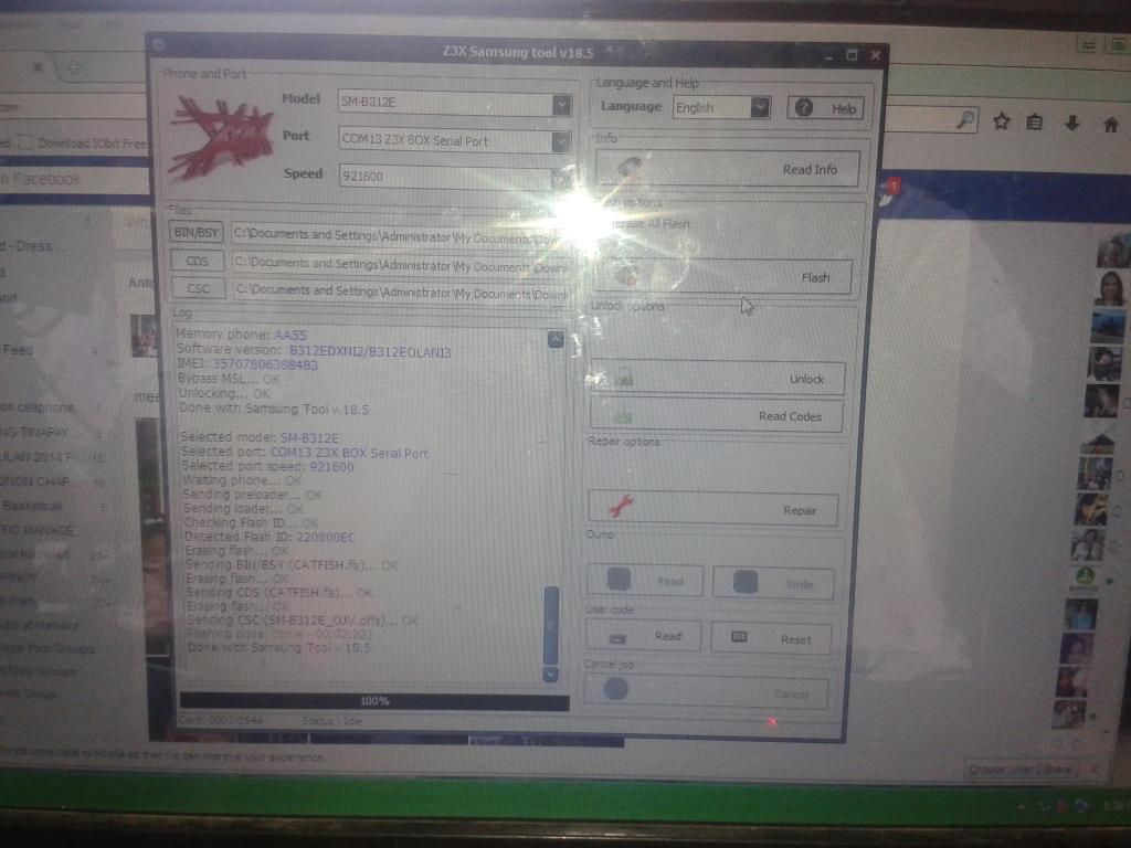

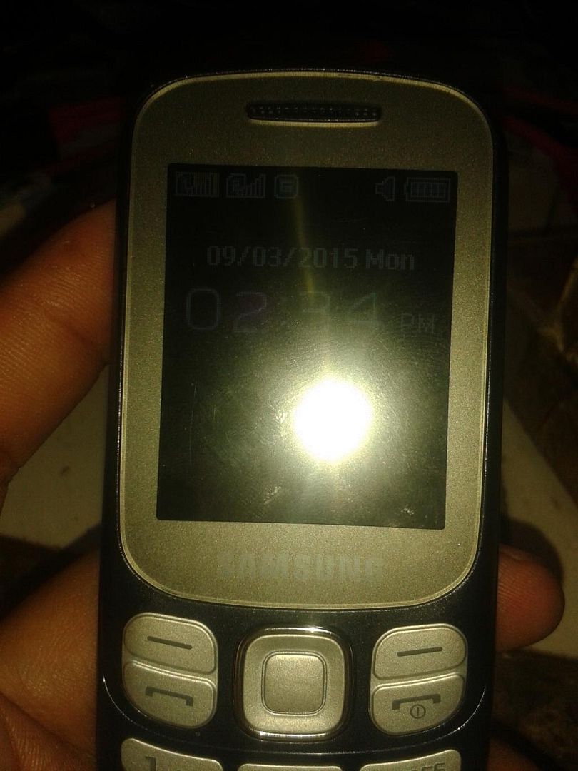

share ko lang tong napolot ko ngayon
sm-b312e phonelock done
read code ko xa may code na nabasa pero wrong code
direct unlock may phonelock parin
kaya wala akong magawa flashing ko
hanap kay google sa awa ng dios may nakita ako
http://www.mediafire.com/download/kzhi1y50wwhva90/GT-B312E.rar
open shell 18.5 version
chose correct model tick flashing
pindot sa home button sabay saksak ng usb
-*wait until finished
pera na
400 petot singil
