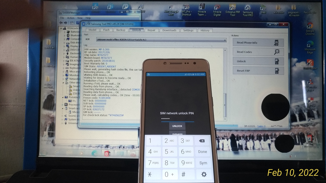

Phone in normal mode, go to settings – enable usb debugging
Type *#0808# - select the last one
Run z3x Samsung tool v39.6
Select model – sm-g532g
Select unlock
Connect usb cable to pc
In adb – check if phone is detected

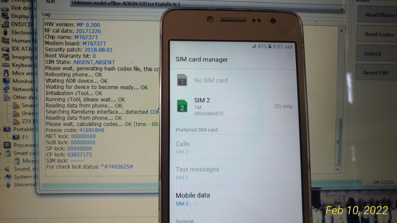

Click read codes –
Wait till done =
Sm-g532g network unlock – no root required using z3x
Select unlock
Click read codes –
Wait till done =
Tested skin Read Codes
