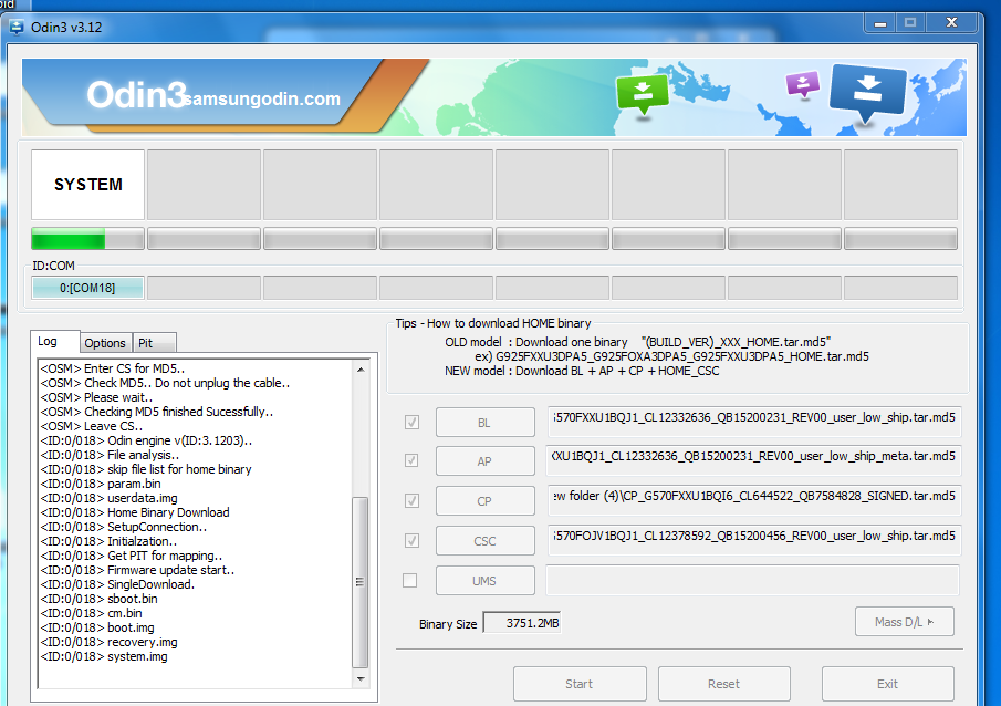

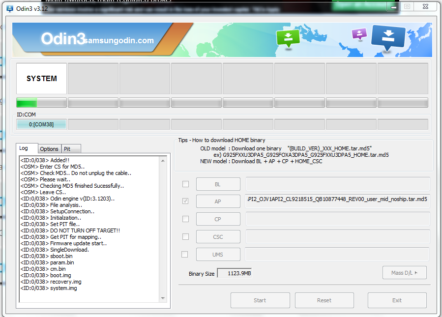

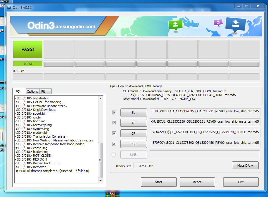

flashing muna combination file sa odin

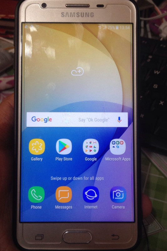

done na
mabubuhay nayan kaso factory binary lalabas
di ko na nakunan yung naka binary tignan nlng video

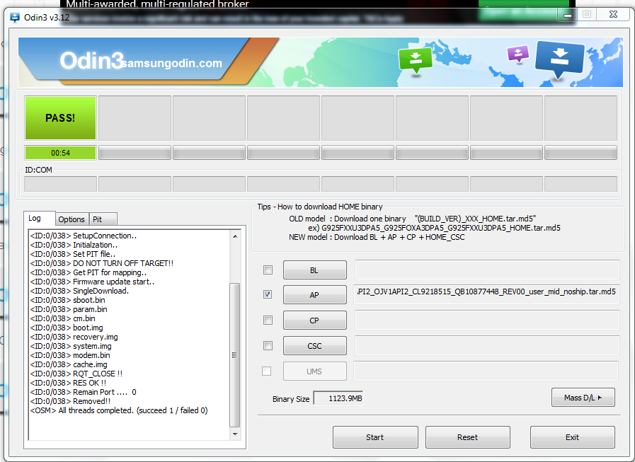

sunod flash na stock rom using odin padin
flashing done
finish na

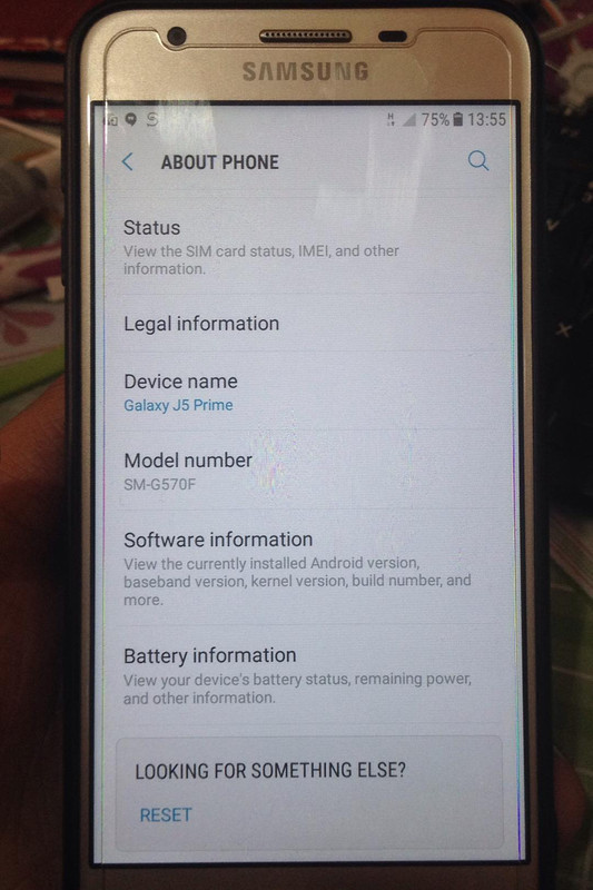

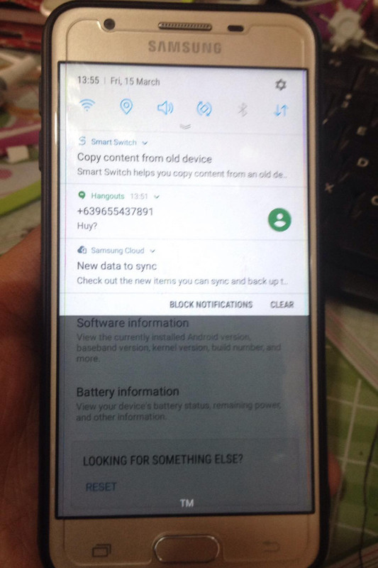

signal ok
