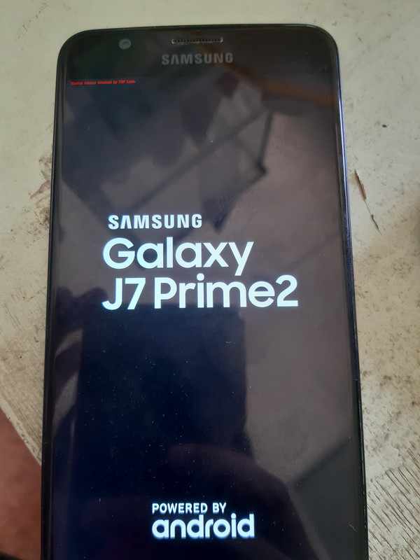

share ko lang mga boss sm-g611f(samsung galaxy j7 prime2)custom binary blocked by frp lock done sa odin flashing..

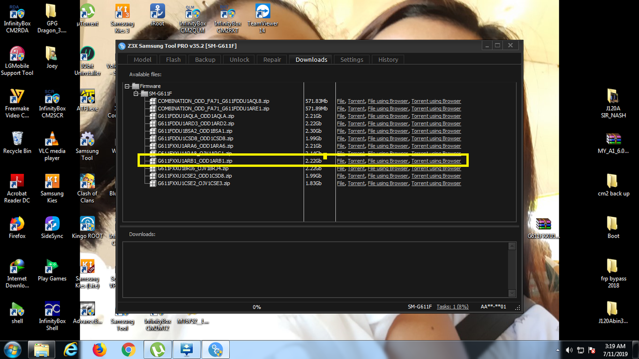

una ko ginawa ay kumuha ng firmware sa z3x support..
at ito nman po ang firmware na ginamit ko....

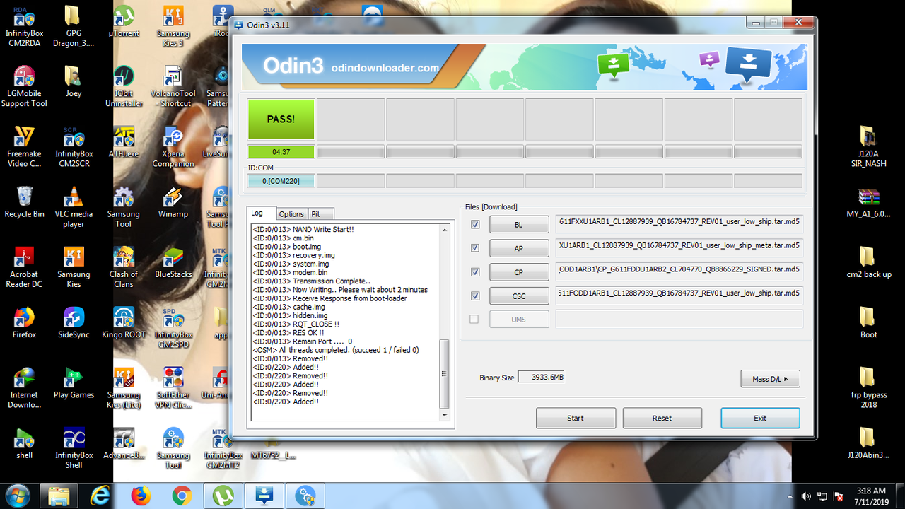

after download
extract firmware
open odin flasher
load firmware
put the phone into download mode
insert usb cable and hit start

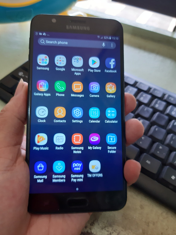

DONE...
