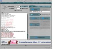

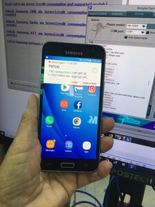

sm-j320a openline via octoplus
run octoplus samsung tool version 3.0.7.4
select exynos
select model sm-j320a
phone in normal mode type *#0808# select dm+modem+adb, enable usb debugging, connect usb cable to phone
click read codes select via diag port
wait till done
