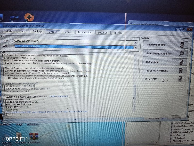

history:ni reset daw ne tumer
action taken:reset muna ang phone para lumabas ang adb,turn off your phone,press vol up,home buton and power buton,select wipe data factory reset,reboot.
open z3x samsung tool Pro v39.2,select model j510gn and goto unlock .
conect phone at lalabas ang usb debuging at e check.select adb and click reset frp .done
