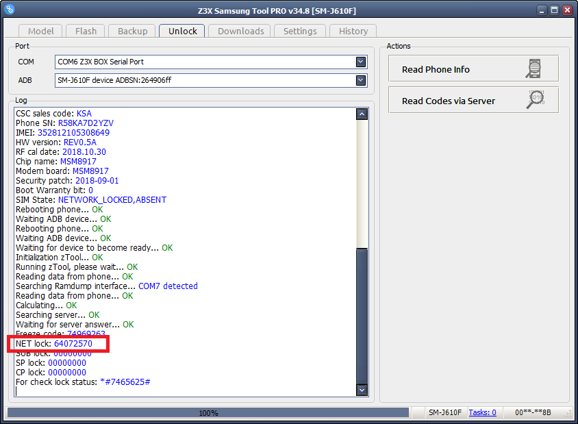

SM-J610F UNLOCK by Z3X 5Credits DONE!
Procedure:
1.On Debugging
2.OEM no need to enable
3.Dial *#0808# choose DM
4.Preper atleast 5Credits to Z3X
5.Read Code Via Server

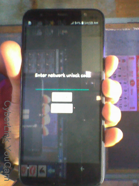

6.Power On your Unit, type your code from " Read Code Via Server "
7.Viola P1,800:):):)
Finish Product:
