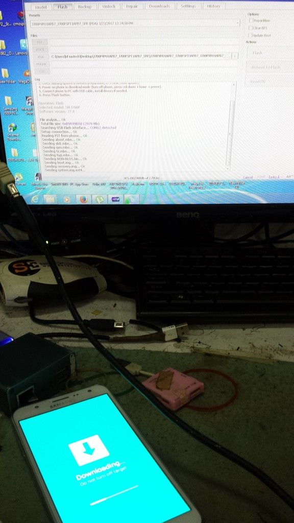

problem ;unlock
actionn taken;
try unlock in z3x without root NO LUCK, octopus not supported
search dito madami rin naka succes...ako NO LUCK
kc after flashing root using this
http://www.mediafire.com/file/y1i4mdkeem7hm16/twrp-3.0.2-0-j7ltespr.img.tar
walang recovery mode...para sunod sana ma iflash eto
http://www.mediafire.com/file/5nwpzm7qvq2m4o1/BETA-SuperSU-v2.74-2-20160519174328(2).zip
naloko na...
pero as usual dito tbasta sumusuko...downgrade solution
kaya eto na ang cya...
log flashing
File analysis... Ok
Total file size: 0xB9A99BA8 (2970 Mb)
Searching USB Flash interface... COM12 detected
Setup connection... Ok
Reading PIT from phone... Ok
Sending aboot.mbn... Ok
Sending sbl1.mbn... Ok
Sending rpm.mbn... Ok
Sending tz.mbn... Ok
Sending hyp.mbn... Ok
Sending NON-HLOS.bin... Ok
Sending boot.img... Ok
Sending recovery.img... Ok
Sending system.img.ext4... Ok
Sending cache.img.ext4... Ok
Sending modem.bin... Ok
Flashing done (time - 00:06:26)

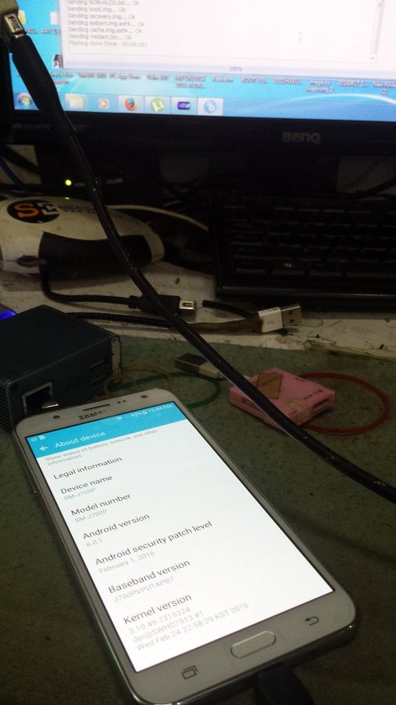

logs in unlocking
Waiting ADB device... Ok
Reading phone info...
Model: SM-J700P
Android version: 6.0.1
Product code: Not Active
Phone version: J700PVPU1APB7
PDA version: J700PVPU1APB7
CSC version: J700PSPT1APB7
CSC country code: USA
CSC sales code: XAS
HW version: J700P.03
Phone SN: 00000000000
Modem board: MSM8929
RF cal date: 2016.12.14
IMEI:
Writing AT RIL... Ok
Initialization AT RIL... root required
Checking Super user right... true
Initialization AT RIL... Ok
Unlocking... Ok
Rebooting phone... Ok
Unlock done

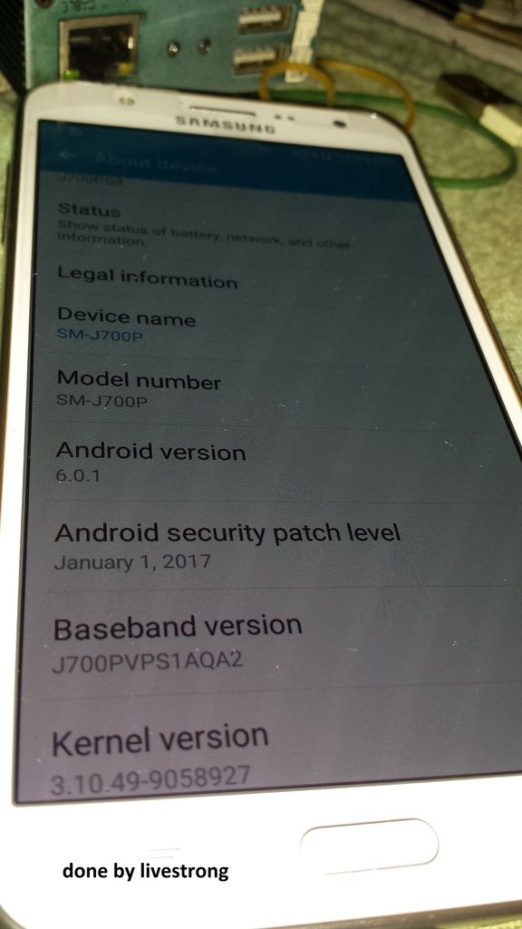

after root and unlock medyo may problema parin nag la lags at may error...
so to remove the error flash to its original stockfirmware
after flashing
heto na cya...
done:x:x
