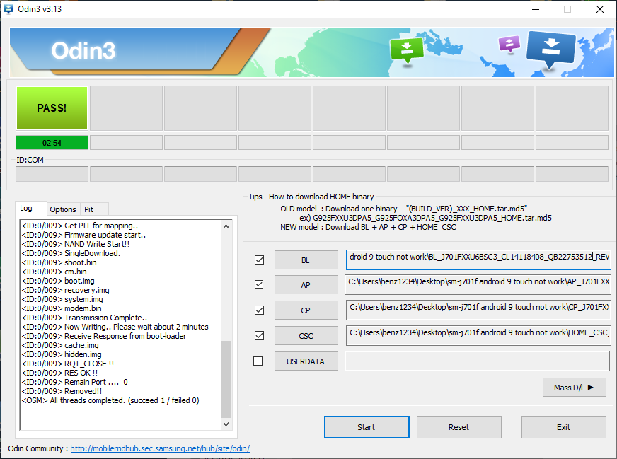

Sm-j701f touch not work after update to android 9.0
In Download mode – frp off, oem on
In recovery mode – this is the firmware version= j701xxu6csf1 (9.0)
Check first unit using otg – naka pattern lock = hard reset muna para mawala pattern lock-
Download this firmware from sammobile = j701fxxu6bsc3 (8.1.0)
Solution: downgrade firmware to 8.1.0 same binary
Open odin 13.3
Load 4 files bl, ap, cp, home csc
After complete flashing, phone will open but requires password = irecovery mode lang then wipe/reset
After rebooting touch working = then do the setup.
