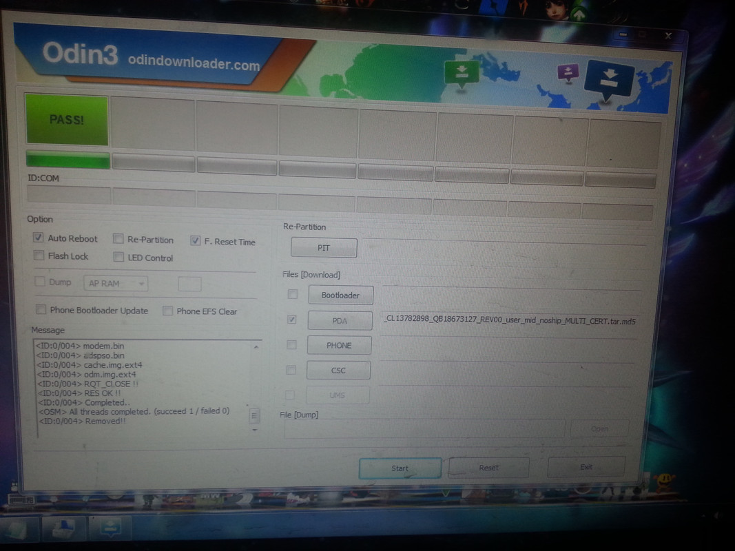

SHARE KO LANG MGA KA ANT J810Y/DS FRP AND FULL FLASH DONE SA ODIN
1ST DOWNLOAD MUNA LAHAT NG FILES
COMBINATION FILE HERE:
https://drive.google.com/uc?id=1gvfnXakxHyWJ8-MxlTIsIFVRmQTEQg9c&export=download
FULL FLASH FILE HERE:
https://drive.google.com/uc?id=128etbqj15NASv3gM0oHP0ARg8g6x9bsO&export=download

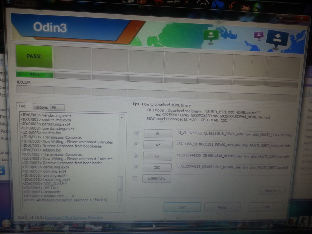

DOWNLOAD ODIN DAPAT LATEST

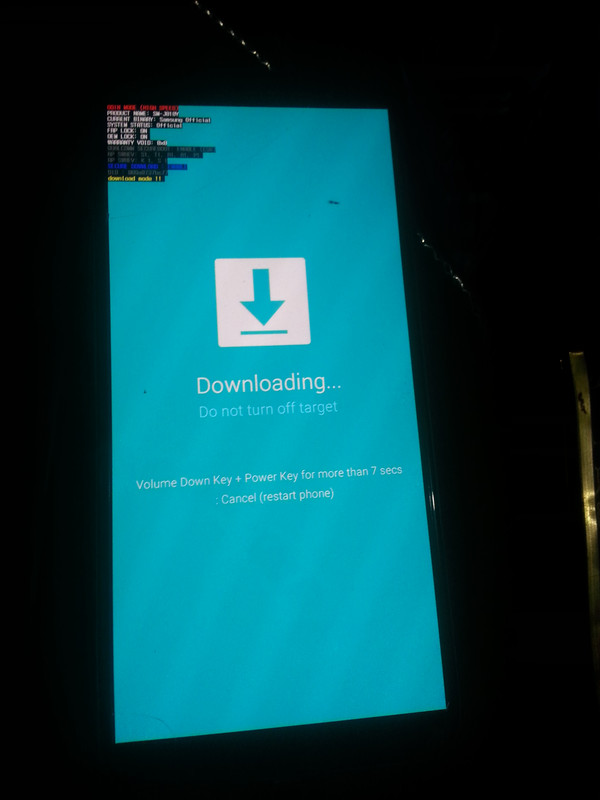

TO ENTER TO DOWNLOAD MODE PRESS VOL. UP+VOL DOWN SABAY SALPAK USB CORD CONNECTED TO PC OR LAPTOP
find nearest compass bank

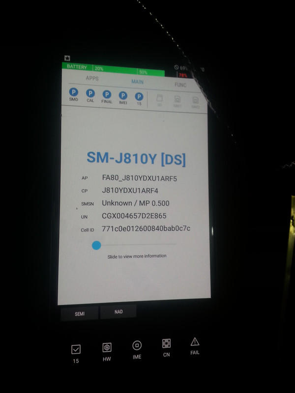

OPEN ODIN FLASH THE COMBINATION FILE
how much does anthropology pay

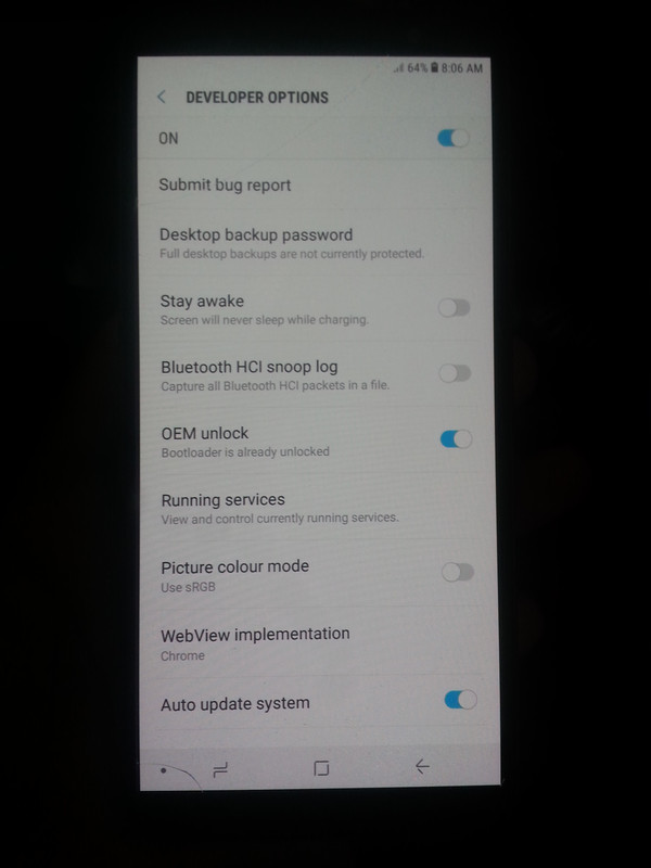

AFTER FLASH THE COMBI GO TO SETTINGS TO DEVELOPER CHECK OEM UNLOCK AND SWITCH OFF PHONE
woodforest bank locations
THEN FULL FLASH
find me the closest pnc bank

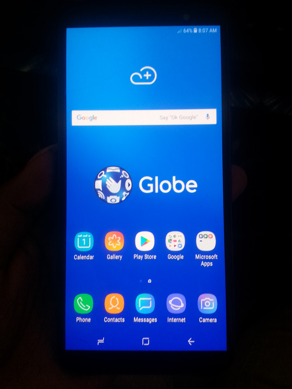

DONE AND ENJOY
HIT THANKS IF YOU LIKE
ANT-AVEGUEL
