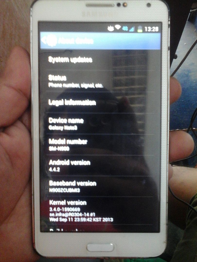

dumating po sa shop hang lang po sa logo
try ko Hard reset pero hang pa din
open ko SP FLASHTOOL v5.1348.00
format ko muna kc mag mtp error xa
format whole flash except bootloader
tapos nun FLASH ko na sa firmware na to dl nyu nlng http://www.4shared.com/rar/cb804UHwba/MT6572_SM-N900.html?
xenxa na dko nkuhanan ng image habang ng flash
eto na po xa alive & kicking
d pa po tapos yan .
pag hang parin po hard reset nyu lng po and wait .

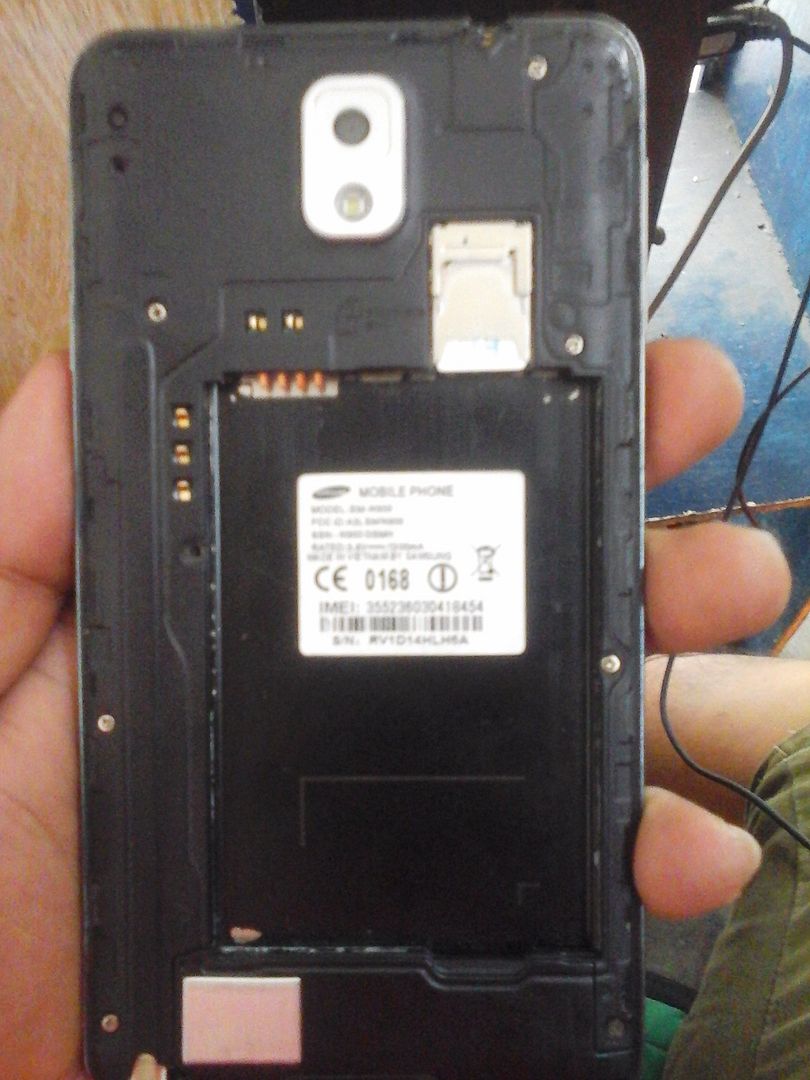

WRITE IMEI ko po sa volcano kc nawala po imei nya
pwede din po ito kung wala kayu volcano para sa INVALID IMEI
1. Go to phone dialer
2. Dial the Code *#*#889988#*#*
3. you will be redirected to its EngineerMode
4. Scroll up and Tap GPRS tab
5. Then type the IMEI found at the back or box of your phone then press attached\write button
6. Phone automatically Restart
7. check IMEI by dialing *#06# if it is correctly written
8. Presto then you successfully written your IMEI!
