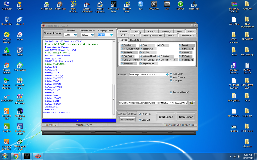

ito boss prince read info ko?
boss prince ito ung read info ko?
CPU: MT6582 SW:0001 Ver: CA01
Downloading Boot8 ...
EMMC Size: 0x01D2000000
Flash Type: EMMC
INT/EXT RAM Size: 0x0+0x0
Reading infr(EMMC)...
version:4.4.4
model:SM-N910C
brand:alps
manufacturer:alps
Flash Type: EMMC
version:4.4.4
model:SM-N910C
brand:alps
manufacturer:alps
ayuun mt6582 , try mo yang last fw na sinend ko (l:0

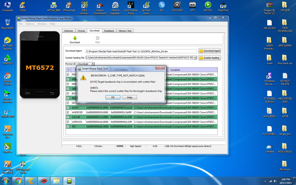

boss sakit na sa mata, hayys pacensya boss wala ako makita puro mt6572 lahat di magka compatible chip. try ko ask mga kaibigan ko
ayw tumoloy boss julay
spft boss try mo boss o peranha crock boss pero sa spft ko yn gina wa diko lng na e post kc nag blue scren nong malapit na konin ni tomer un nag disply sia workeng naman po heheh di ko lng alam sa u kong bakit try mo lng spft o peranha bossgod lock
dwlod ka pala nong spft na my kasamang driver ung my driver talaga na kasama na kalimotan ko kc kong san ko un na koha heheh bsta ung my driver na sama sa spft
kaparihas yan ginagawa ko pero sa akin chipset MT6572 samsung sm-n9100
gamit ko kay boss hazim chip type not match program ko rin dito same chipset

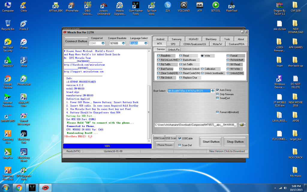

chip type not match parin ginawa ko mc crack ito info.back up then program yung back up nya
pero no luck parin after flashing.
ito pic.
fter back up flash ko sya sa firmware.
done sa flashing pero hang parin.

kasi bago ko ito na program lollipop version po ito
flash ko sa ibat ibang firmware no luck boss chip type not match boss?
